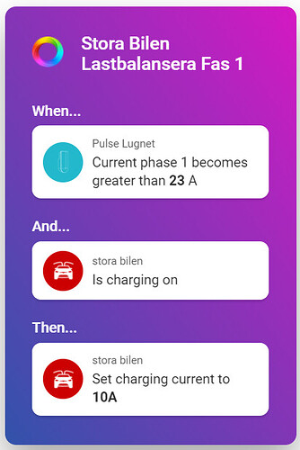

I want to try and load balance my car charging with Pulse that gives me real time usage per phase.
I have created a flow like this:
https://homey.app/f/iwh9VV
But is there a way to just lower the charging power in increments instead? Like lower it by -1 each time a phase is nearing full utilization?

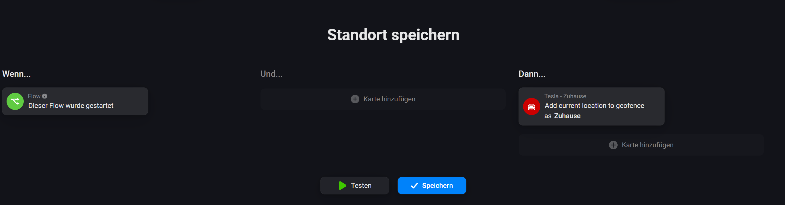

Gegeben falls musst du deine Arbeit als Lokalität speichern sofern du das nicht schon gemacht hast.
Ich würde auch das “Location accuracy (m)” auf maximum, also 250m setzten. Die Ortung ist nicht immer Meter genau.
So speichere ich meinen Standort
So habe ich das gemacht.

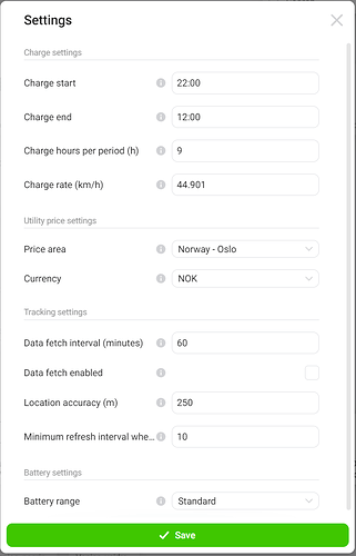

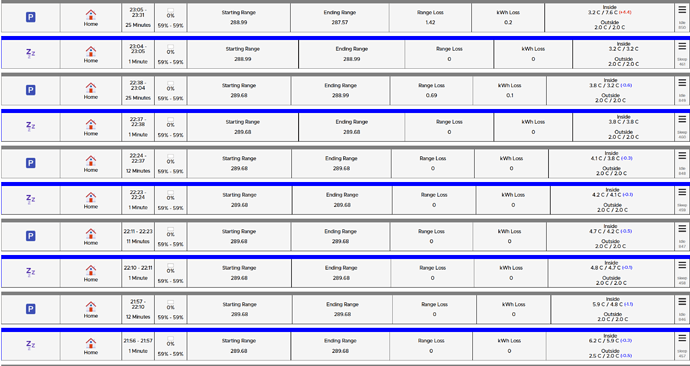

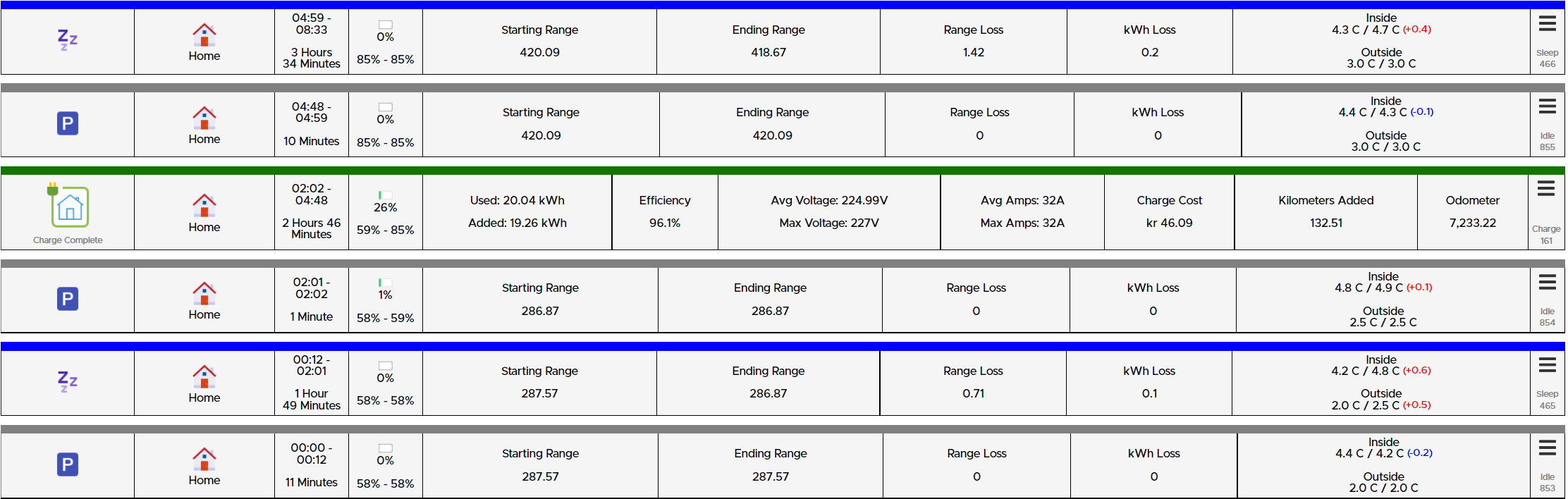

The automatic charging logic is very nice. But I see a problem with a car sleeping in charge period. When it begins (in my case 22:00) every 11 minutes the car goes into a sleeping state and right away wakes up (teslafi shows 1 minute sleep but it wakes up right away after sleep starts. As a car standing right after the bedroom wall, I hear like all relays clicking ). It is going on until midnight (00:00). After that, the car sleeps without a problem and charges in time. What can be wrong? I tried to disable all flows connected with the Tesla smart charger app but it does not help.
By the way teslafi did not catch all sleeping events. Where 25min parking, there suppose to be sleeping state in the middle. I was tracking in developer mode vehicle state.
