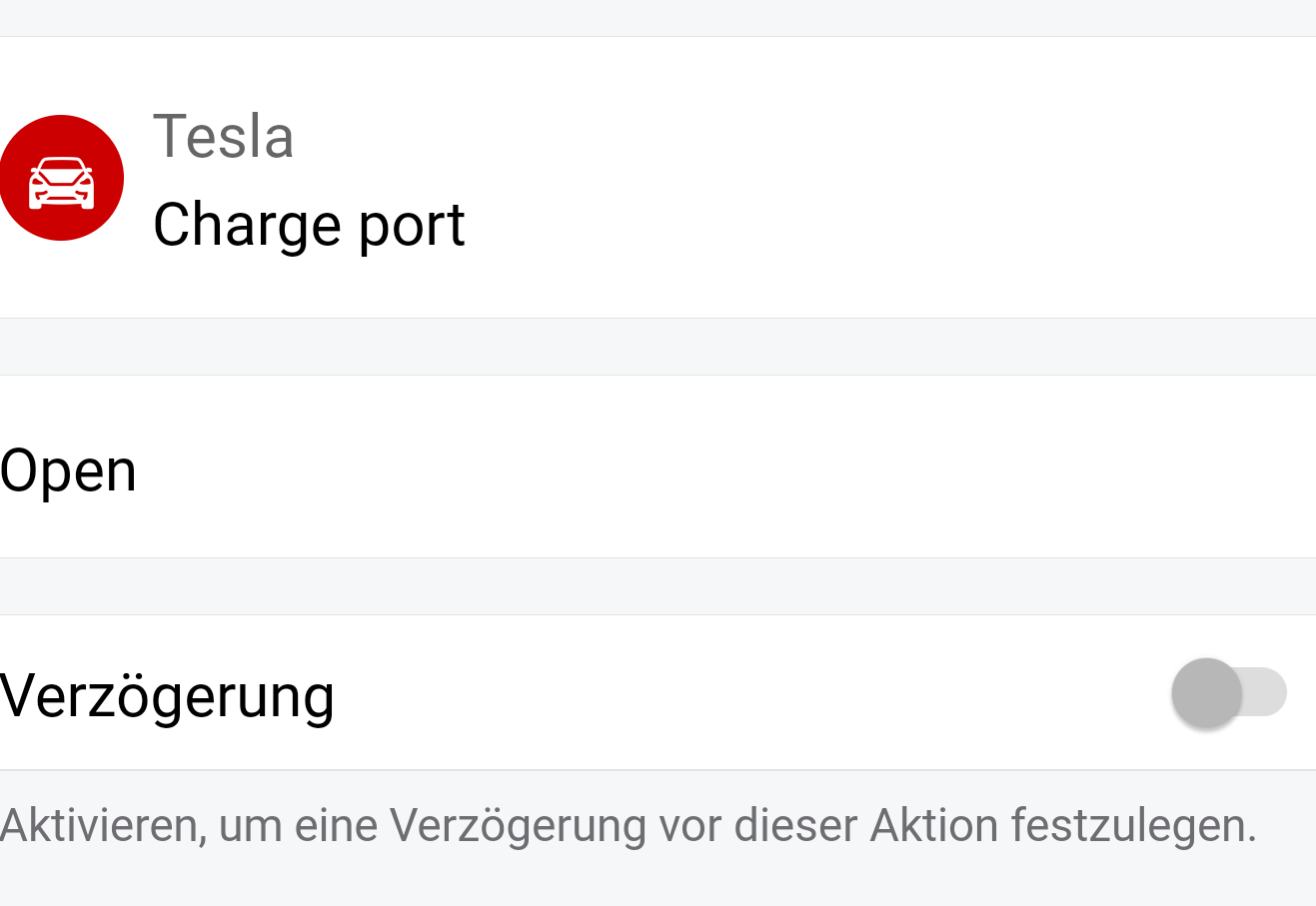

the unlock charging port function is not supported?
Greetings
Philipp
This unlocks it

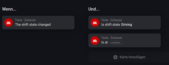

i made this flow to send a message when i leave the work place, but i don’t get the message, what’s wrong?
227748
Best regards
philipp
If you left location you are no longer at Arbeit
Try this
@balmli does this mean that a driver is sitting on the driver seat?
