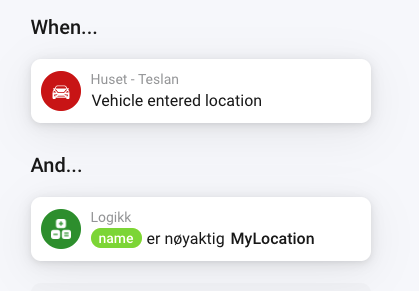

I am probably stupid but how do I set the location?
By using an AND card after your WHEN card.
@Mathijs_Kok The name of the location is provided by the “Vehicle entered location” trigger, so you can check that.
Skjermbilde 2021-10-07 kl. 07.16.36
