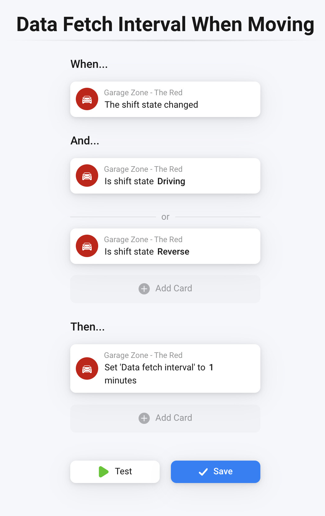

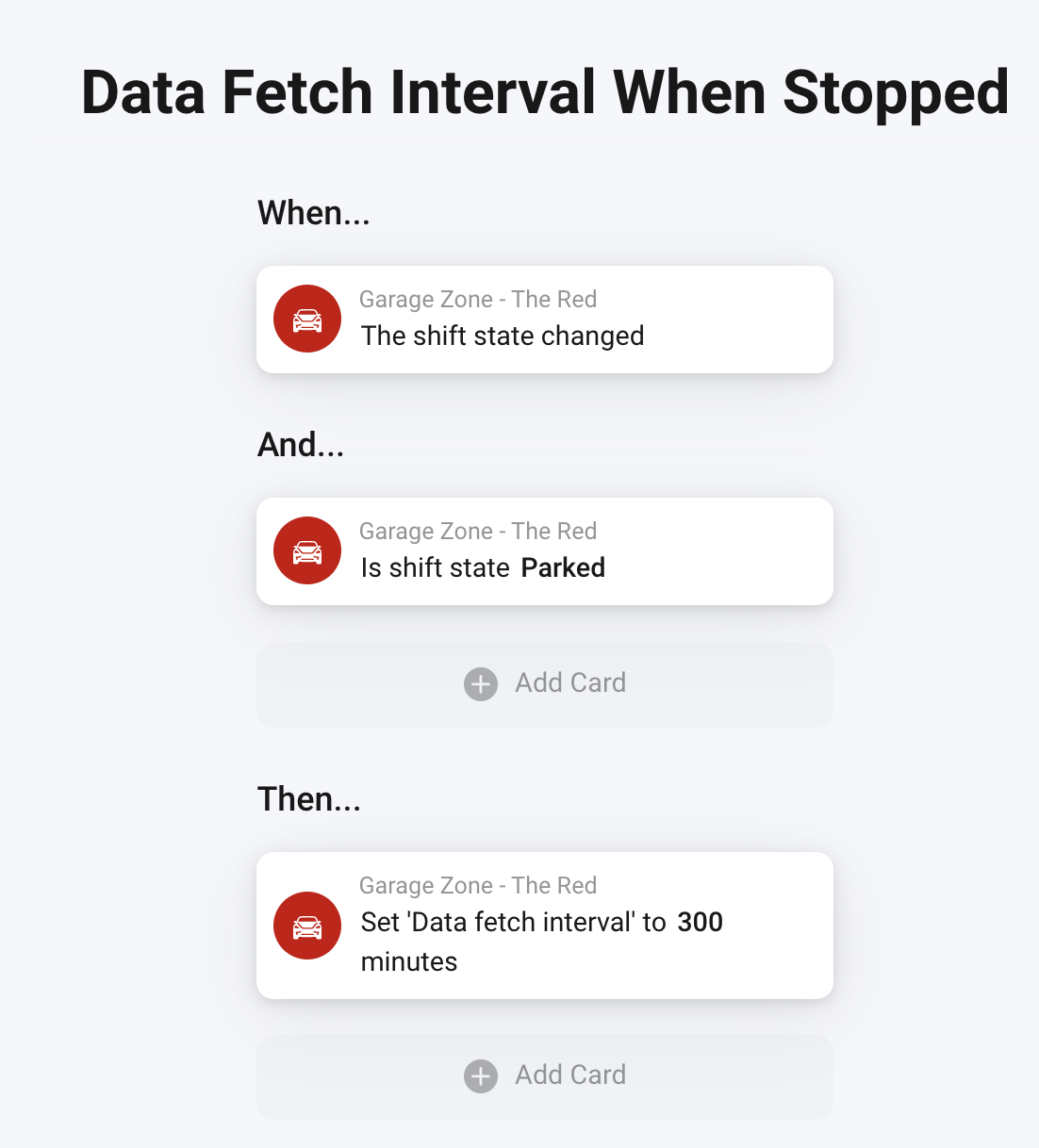

If I set the data fetch interval to a small value, the car will be woken up very often and as a result the battery will get drained rapidly. This is the reason I am trying to create flows that will change the “fetch interval” value.
This is what I have done:
and
I think this will work. I will give you a feedback later tonight.

After creating the flows controlling the “Data Fetch Parameter” (when moving set to 1 min) and when stopped set to 300 and verifying that they are working by sending notifications, the car is seldomly starting the the flows triggered by Vehicule came home or Vehicule left home.
For instance, yesterday it worked twice out of the four time the vehicule left and came back home. This morning, it did not work at all. By that I mean that the flows did not get triggered.
