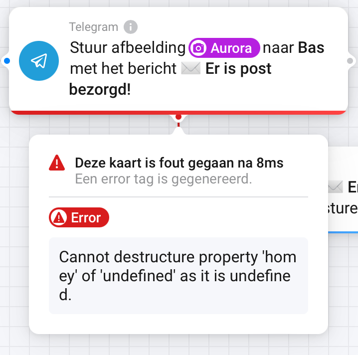

@spkesDE Homey Pro 2023: I’m trying to send images from an image tag, but it doesn’t work.
Depending on the kind of image tag I’m using, these are the errors:
Image tag from the standard Homey Virtual Camera devices:
Image tag from a Homey Gallery image:
Any idea what the problem could be?
I’ll check this out. Most likely there is no cloud URL.
Could you use the latest test version?
And send a Image Tag card without text! and create a diagnostic report?
I can’t get image tags to work on my HP2023 right now.
