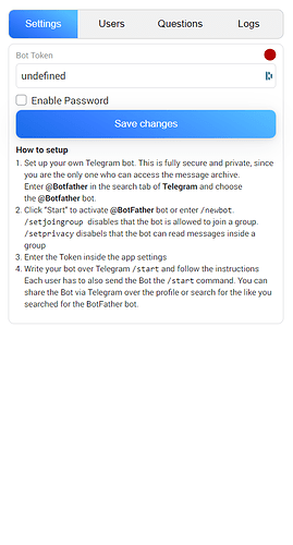

Just a little teaser :slight_smile: Still no homey, but I can develop some stuff without it.
I hope the shipping will start soon of the new homeys!
