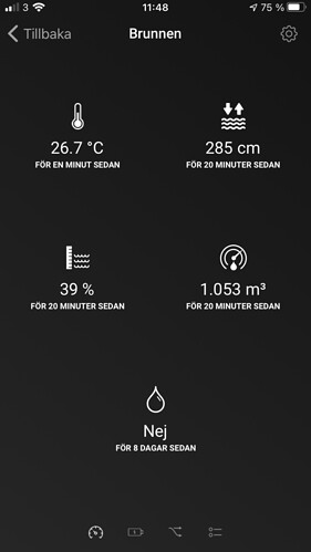

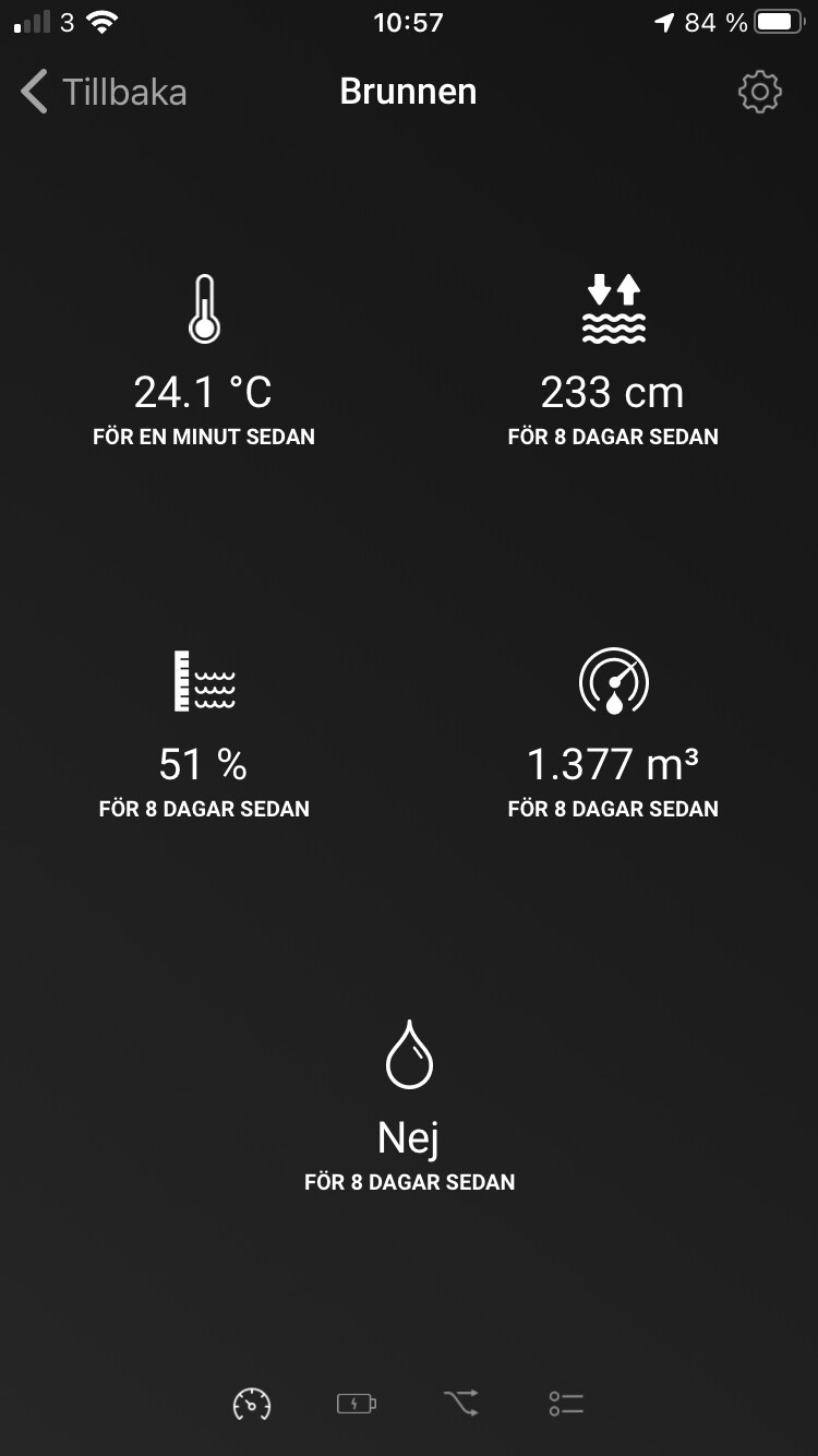

Love what you have done with this app! I have installed my tank level meter in the well about 10 meters from Homey. I get frequent temperature updates but no updates from the rest of the parameters. Am I doing something wrong?
You can check the advanced device settings. If the min/max levels are not filled in correctly you can get an ‘out of range’ and it will ignore the measurement. If so it would show out of range messages in the app logs.
If the min/max is correctly set it could be that the sensor itself is not working properly. Does the sensor display show the correct level?
Edit: and I forgot about another possibility: the level actually hasn’t changed. Did the level change in the well?
I have not used the sensor display, only Homey. I now opened the well and ”yanked” the sensor a bit. About a minute later; the parameters updated in Homey. I guess it could be a range-related problem. Seems strange, however, that the temperature updates frequently.
If the sensor is not getting a good distance reading (e.g. because it is not mounted exactly horizontal) it will keep transmitting the last valid value. Hence Homey will not update the air gap and related values.
Ok. It keeps updating now, so I guess the problem was the sensor not beeing completley in level. Thank you for your effort with the app!
