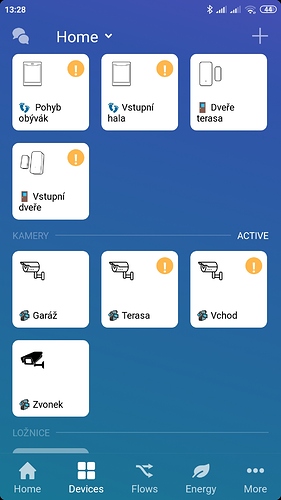

New test version (0.0.24) that adds the motion alarm to the device tile.
This required changing the class from camera to sensor but I can’t see that it takes anything away but let me know if you see anything that goes missing (or should that be don’t see :slight_smile: ).

First of all congratulations on this application. After testing the different versions I had better operation on the different camera brands in version 22. With the following some of them no longer work. And would it be possible to change the CLASS of devices to “CAMERA” type as before and not “SENSOR” as is the case in the latest versions?
If I change the class back to camera then we loose the notification icon on the device tile. Is it something specific that you think the change has caused?
What is not working now that was working?
Have you tried with the latest test version and setting the prefer Pull point event option.
I coded part of the homeydash interface to display the image of the cameras when we click on their icon.
There is a previous version where one of my cameras displayed notifications and the “Camera” Class on homeydash.
I tested the latest version which is indeed more stable on event detection. But some brands do not display the notification on homeydash but on the mobile application.
And another brand detects a bad PORT and therefore the camera is not accessible.
I will look into Homeydash as i do use that but just not thought of putting a camera on it. I tried lots of things but couldn’t find anything that stopped working when set to sensor. Maybe I can make it an option in the advance settings so users that want the notification icon can set it to sensor while others can set camera.

I have pushed a new test version (0.0.28) where the device class can be selected in the advanced options.
I have tried adding a camera in homeydash but it doesn’t show the image so was that a change you made to homeydash?
I will test it thank you, for displaying the camera image on homeydash when we click on it I added a piece of code in the file homeydash.app.js
