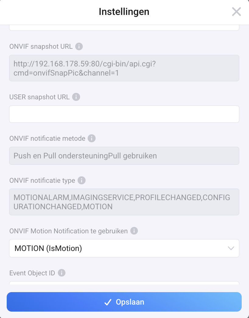

Hi Adrian,
Person detection is disappeared from all the cameras except one. See below the types as you requested.
Here is the snapshot from the web where person detection is missing
Snapshot from the camera where person detection is still there
I know you already said you are having a look so will wait for your message.

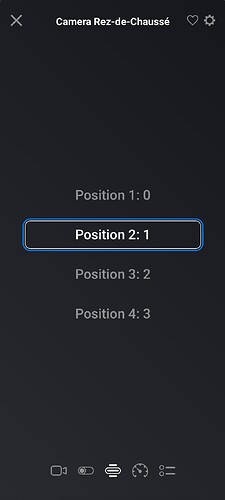

Hi @Adrian_Rockall I also have the same error when trying to add a PTZ Card
”ONVIF SOAP Fault “SOAP-ENV:Sender”:”
Could you send the Diagnostics Log from the app settings page.
Change the option to Detailed information and then try to add the camera. Once it has failed, go back to the log and Send it.
The first try if through an advanced flow and it does not work.
The second try if from the device tile and it works.
Here are the logs gathered:

I see that the preset number are 3 digits. Here are all the presets working when doing it from the tile of the device and not from an advanced flow.
