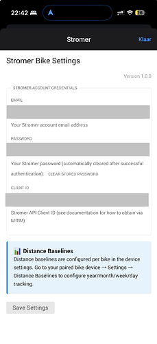

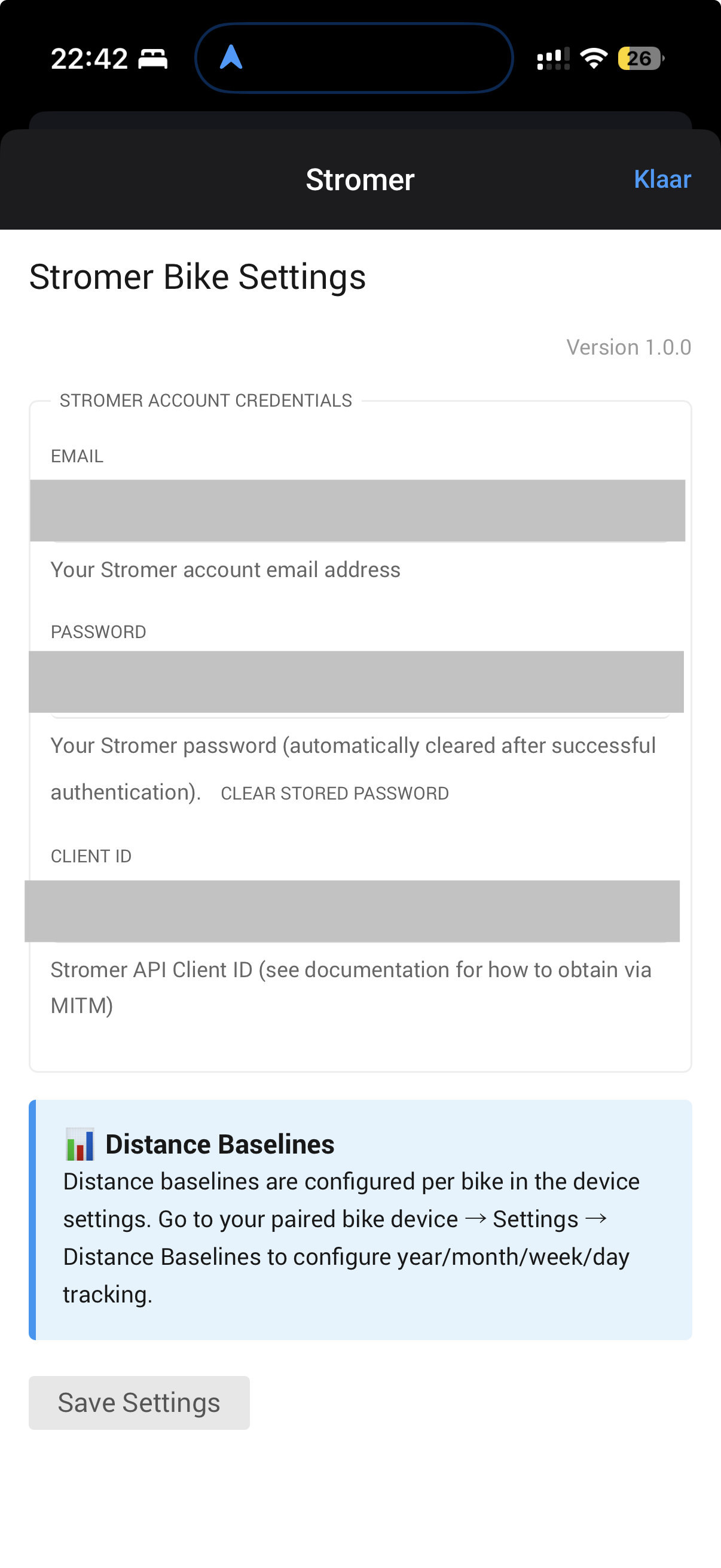

Tried adding my bike and followed the instructions to add my credentials and client id first via the app, but the app won’t let me add my bike :worried:
Made following diagnostic report: e0a25cf2-3243-46ed-bb9d-bd983eebdcee
Would you mind send me a DM with some details (can’t find the crash report)
No problem and done.
