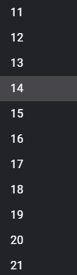

Was thinking about if my Wifi is interfering with Zigbee. Wifi has channel 1 and Zigbee has channel 14 so there shouldn’t be a problem.
My Aqara motion sensors seem to work fine so it shouldn’t be a Zigbee problem either. Has anyone had the same problem?
Any channel that is better?
