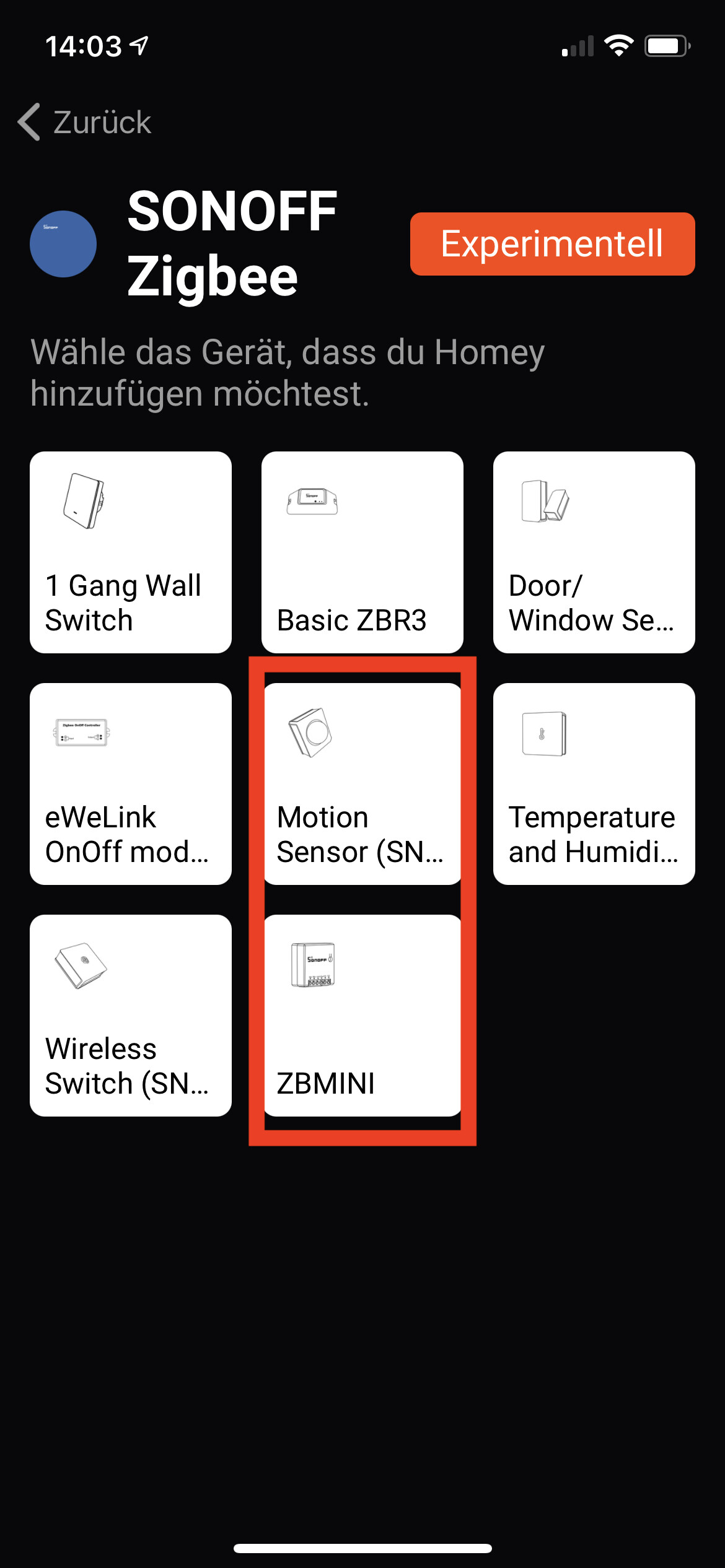

Hi thx for that app. I add some days ago 2 sonoff motion sensors they are working fine. But now, i can’t put some new motion sensors to the app also not the ZBMINI. If i want to add a new device i get only a blank screen. Can you help me? homey 5.0.0-rc.53
Hi @Peter_Hartung, if you are unable to add a device even as a generic Zigbee the problem is not in the app but with Homey. please try pulling the plug for 11 minutes, if this does not help contact Athom.
PS. Always make sure you have enough routing devices among the first 20 Zigbee devices you have added to Homey, else you will not be able to add additional units.
Hi, i don’t know what you mean with generic zigbee :frowning:
The Motion Sensor is working now but it don’t find the Mini. I have the Wi-Fi DIY Smart Switch. Is this the wrong one?
Hi again. Yes, this app only handle Zigbee.
