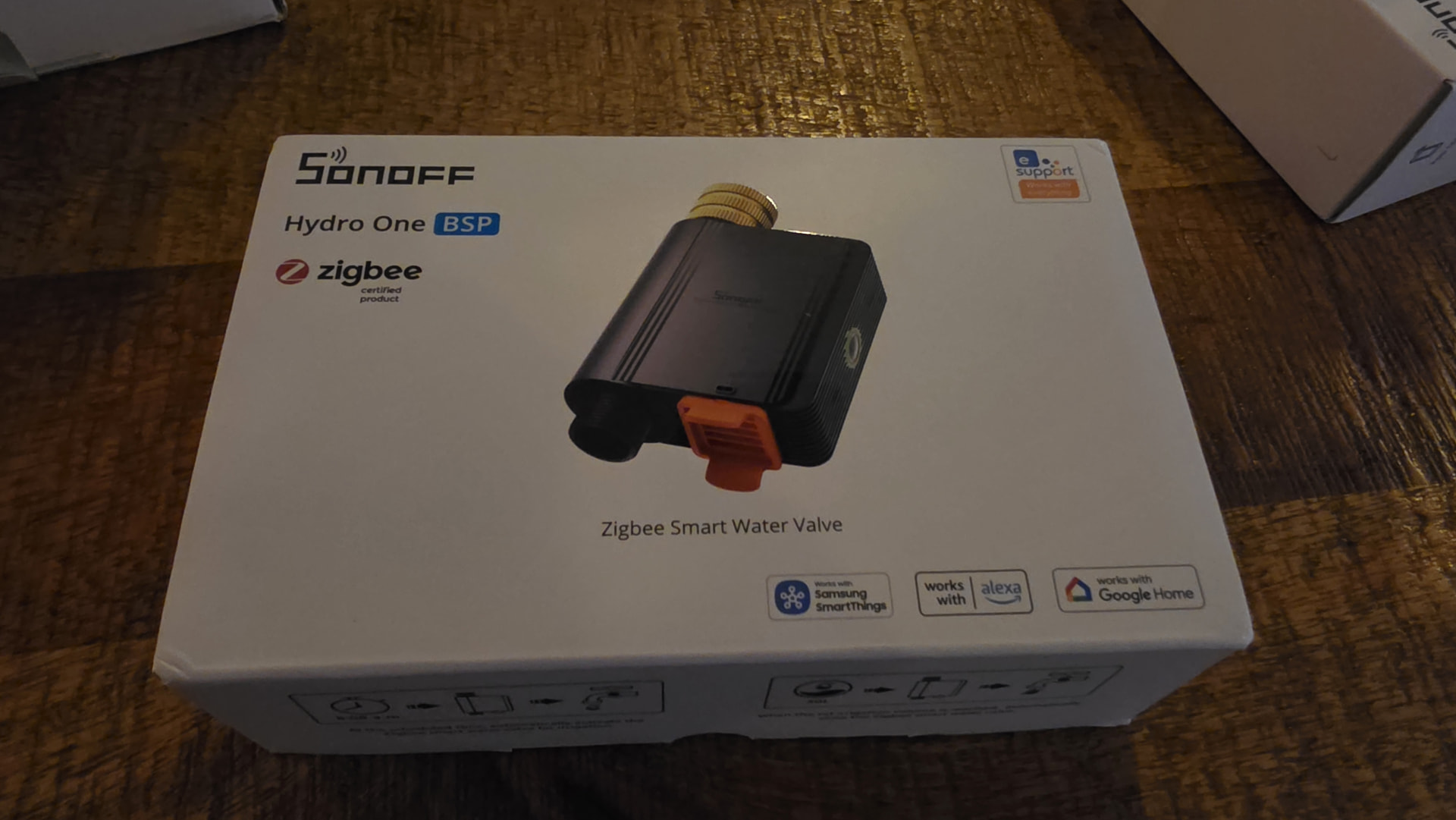

Dear Sir or Madam, I recently tried to install my new water valve, but it continues to be recognized as an unknown Zigbee device. Could it be that this new model has not yet been added to the app? Its the hydro one zigbee of sonoff
It does not seem to be supported yet by the community SONOFF app. But the SWV model should be supported by the official SONOFF app.
Unfortunately, not the new model, it seems. Also in that app Unknown Zigbee
You can contact the developer via the contact details in the Homey App Store and check if the new model can be added.
