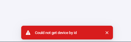

Hello all my ZIGBEE switchers ZBMINI-L2 not working after updating app version to 0.0.26.
Always shown this error:
Please help!

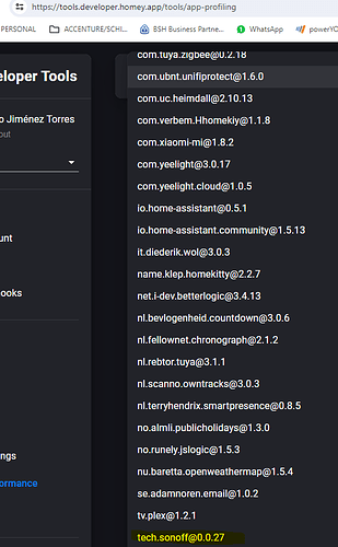

I have created a diagnostic case for SonOff App: e653b5b3-ce7b-4ea6-89f5-19ebf1ca3c00
Also sonoff app updated to 0.0.027 version:
Thanks.
Regards.
Have you updated the app to the version with the fix(0.0.27)?
I’m running 0.0.27. Rebooted my Homey afterwards. But no result.

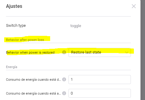

I added some functionality to the device… Power On Control and Switch Type settings. Please try and let me know what works or not… Switch Type is very experimental…
Yes! I have seen that this setting is new, right?
Yes, brand new… I have it in other apps and are testing it in this app.
