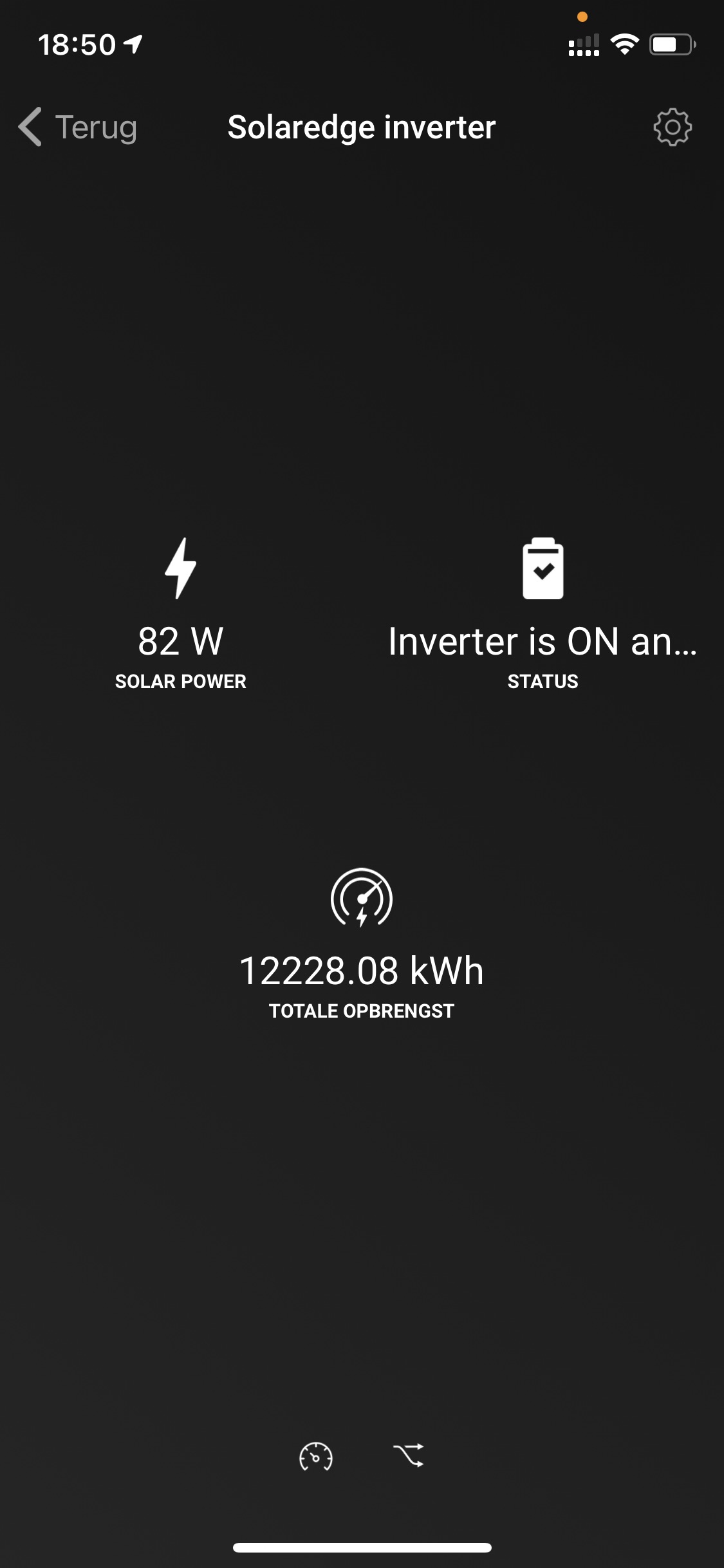

Great job it works.
Nice real-time date from SolideEdge converter
Please add heatsink temperature.
The result is much better than the SolarEdge app.

It works now :+1:
Some refinements needs to be done.

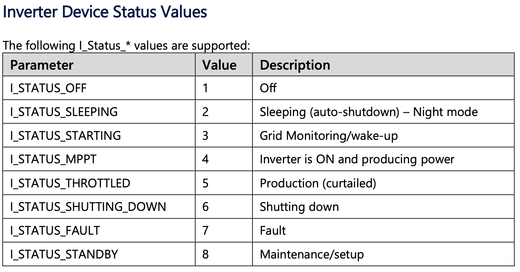

The status in the app is now showing “Batterij standby” and this is not the right description for status code 2.
In the following table you can find the official status codes and descriptions:
Can you please correct these descriptions?
Source: https://www.solaredge.com/sites/default/files/sunspec-implementation-technical-note.pdf

  • Status will be updated in the next update

Status names fix
