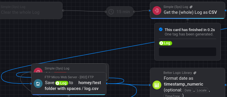

Weird thing here is that when I run the complete flow it gives me this error:
When I only test the FTP client card it works just fine but is the csv file unuseable.
When I try to export Excel (Base64) simple log is set to pause.

Try the ftp card but without any spaces?
Not sure if it matters, but thats my first thought.
A test with spaces in foldernames works for me, the file is uploaded into the folder.
The other issue: the export itself still contains no or bogus data

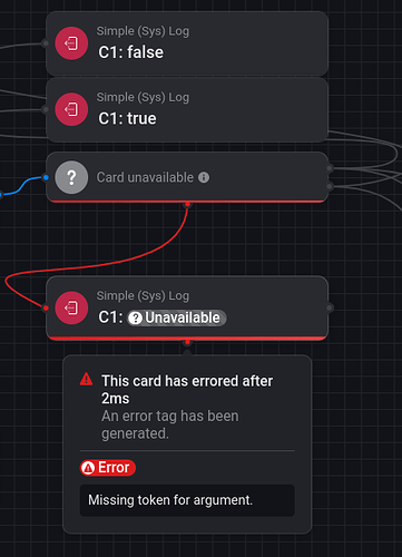

When I add logcards to flows per script, al error cards don’t contain the [error] token of the card it is connected to.
So the error cards never trigger, while they go in error themselves because of the [unavailable] token.

Same issue without any spaces.

What is the Card Unavailabe?
A ssl card?
Please send abigger printscreen.

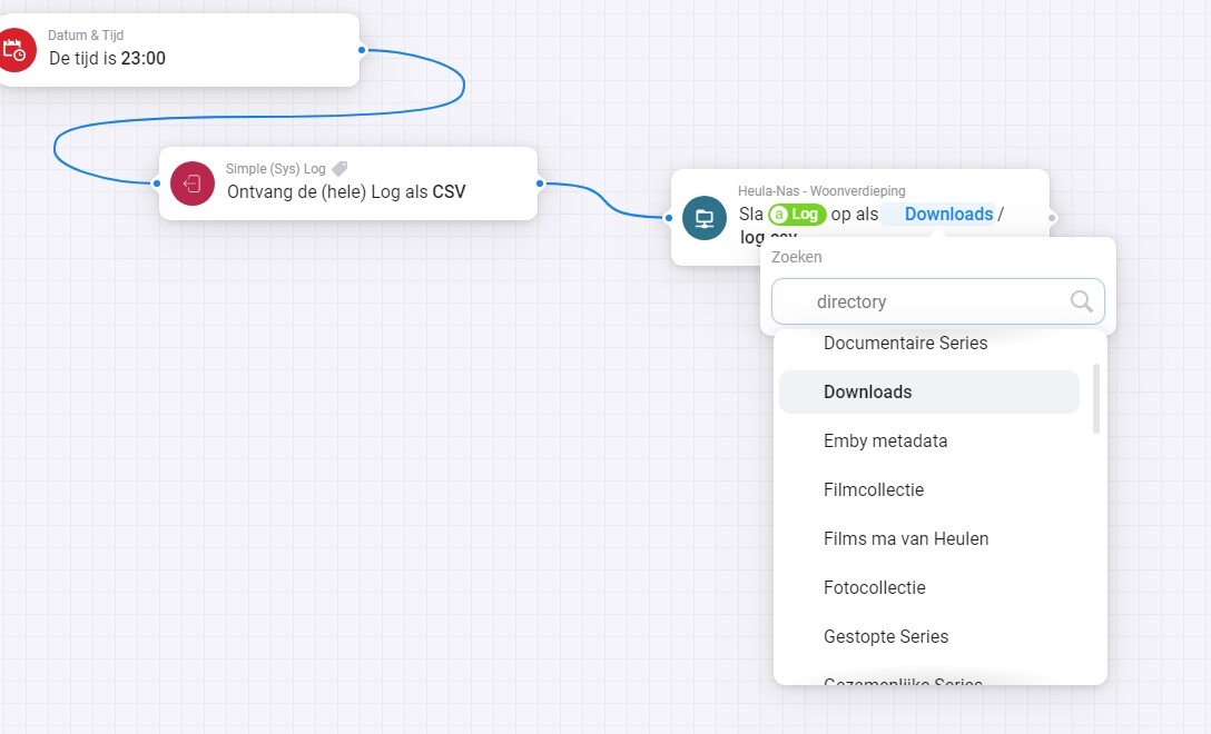

The Download is a selected-from-dropdown, right?
Yes.
Just a card to test with, Xiaomi plant app, no SSL card.
As an example, I show you this flow/ It’s not about the unavailable cards, it’s about the error log cards
Unhidden, you’ll see none of the error logcards, have a valid error tag of the card they’re attached to:

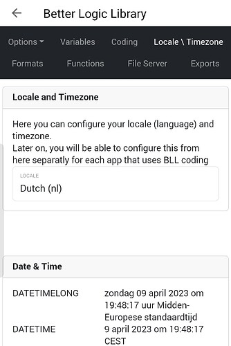

Hi Eddy, what does this BLL config tab Locale / timezone look like?
Same as mine (also Dutch)?

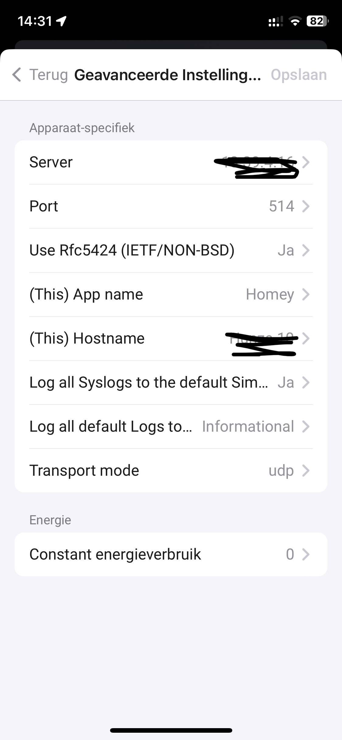

You can send the log to synology in 2 formats, try both please and let me know?
And, make sure bll and everything is up2date ofc.
Hi Arie, Peter,
As you can see, the Locale/Timezone settings seem to be correct. The time of my phone is the same as the settings screen shows.

How/where do I change the format for sending the logs?
In the syslog client device settings
That’s it!!
I have switched off Rfc5424 (IETF/NON-BSD) and now the time is correct.

Im not sure why, but Synology has a bug in it i think.
One definition uses locale time (RFC3164 / the non-rfc5424) and i handle that with BLL (correctly i see :wink: )
However, as far as i could find, rfc5424 should use UTC:
RFC 5424: The Syslog Protocol (rfc-editor.org)
But Synology also has to be configured for which protocol is used, so perhaps you had the NAS on BSD (which is RFC3164)?
