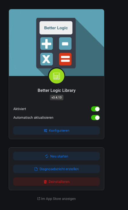

After updating to v10.3.1 of my HP2023, I still get the following error message in the UI of the SimpleLog app (v3.0.33)
Error: Cannot read properties of undefined (reading ‘LogBooks’)
AND
Error: The Better Logic Library App has not been started yet.
However, the app is running:
BDW:
The core fix “Fixes a problem where apps do not receive install and uninstall events” works, I tested it with the “homey-simplelog-api”

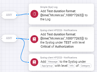

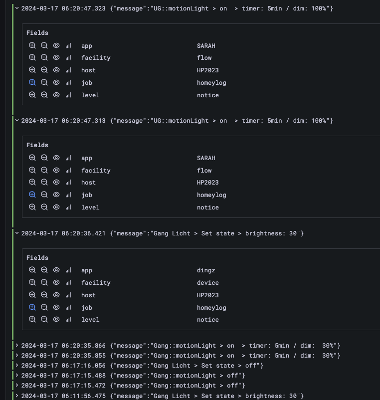

Hi Arie,
When testing my new monitoring stack, I noticed that if you send a syslog message via flow, the SimpleLog app sends it twice to the syslog server. However, when I send a message via the SimpleLog-Api, everything works fine.
