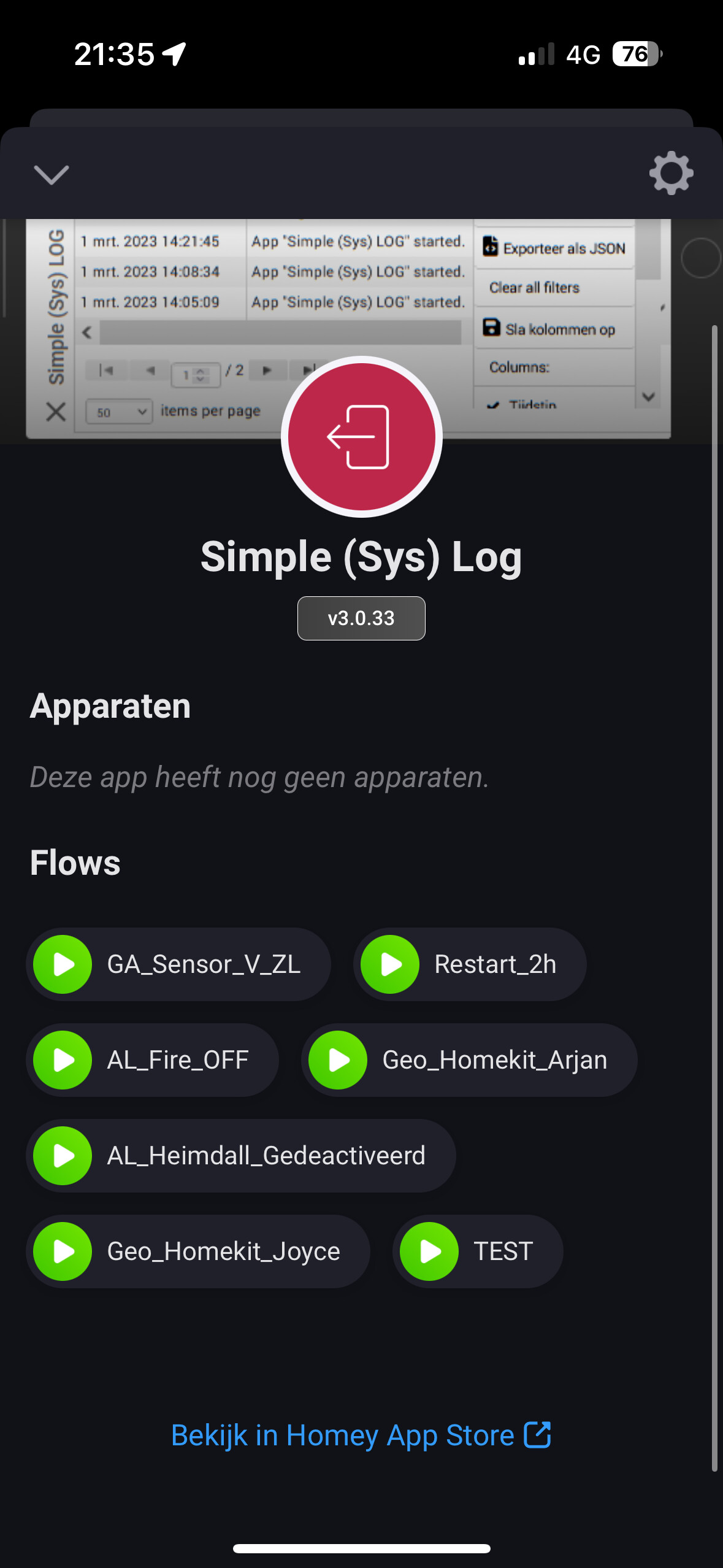

I have a strange issue, the app seems to crash very often. In the logs i get the error App simple log started (50 times in 3 days) .
To be sure it is crashing, create a flow triggered by the “An app has crashed” when card.
Some how no message with the that app card.
but when i look at the the app status is see this

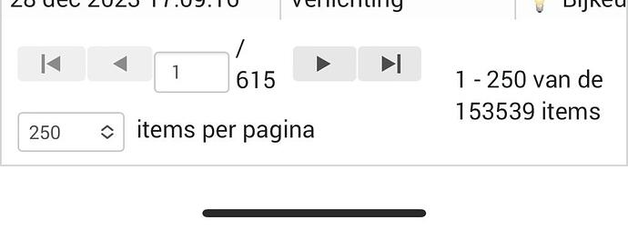

Many thanks for your great app again! Using it very intensive and generating ±5000 log items a day…
Yesterday my homey giving me SCLite database corrupt errors. After some investigation, I found that my CM4 module (eMMC) was not working correct. It was possible to write but not giving the exact same information back. I replaced my CM4 module and everything is working fine now. But… Now it it time to evaluate if it is ‘bad luck’ or that I am doing something wrong… When investigating the log file, i was thinking… Is every log entry a ‘write operation’ to the flash? And if yes, is there something I can do to reduce this actions? For me, logging to RAM is also fine. I would like to look back fo ±48 hours to fix issues or diagnose strange behavior. But it is not important that the data is available after a reboot.
What do you think. Is it possible that the log entries (amount of) can overload the eMMC and maybe max read/write operations or is it just something else/bad luck?
Thanks for your time and info!

My guess is to set up a syslog server for those huge number of logs and days.
Then your eMMC isn’t used this intense, if it is used that intense:
only @Arie_J_Godschalk can tell how and when SSL writes the logs to ‘disk’, and if a syslog server saves a lot of ‘disk’ writes @ Homey
