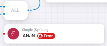

I then executed this card in an advanced flow:
Result: no events received by Papertrail.
If anyone can offer any suggestions to get this working, I would be very grateful.
