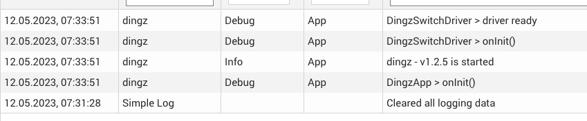

New problem. When I send via the API debug log message to the SimpleLog app, (only) the debug message, are sent twice to the syslog server, in SimpleLog they are displayed only once.

[2023-05-12T05:39:40.357651] Incoming log entry; input='<151>1 2023-05-12T05:39:40.094Z HP23 dingz 17775 - - DingzApp > onInit()\x0a', msg='0x7f9593e2f000', rcptid='0'
[2023-05-12T05:39:40.360152] Incoming log entry; input='<151>1 2023-05-12T05:39:40.094Z HP23 dingz 17775 - - DingzApp > onInit()\x0a', msg='0x7f9593e2f280', rcptid='0'
[2023-05-12T05:39:40.393488] Incoming log entry; input='<150>1 2023-05-12T05:39:40.109Z HP23 dingz 17775 - - dingz - v1.2.5 is started\x0a', msg='0x7f9593e2f280', rcptid='0'
[2023-05-12T05:39:40.433058] Incoming log entry; input='<151>1 2023-05-12T05:39:40.322Z HP23 dingz 17775 - - DingzSwitchDriver > onInit()\x0a', msg='0x7f9593e2f280', rcptid='0'
[2023-05-12T05:39:40.433396] Incoming log entry; input='<151>1 2023-05-12T05:39:40.322Z HP23 dingz 17775 - - DingzSwitchDriver > onInit()\x0a', msg='0x7f9593e2f280', rcptid='0'
[2023-05-12T05:39:40.465595] Incoming log entry; input='<151>1 2023-05-12T05:39:40.410Z HP23 dingz 17775 - - DingzSwitchDriver > driver ready\x0a', msg='0x7f9593e2f280', rcptid='0'
[2023-05-12T05:39:40.465842] Incoming log entry; input='<151>1 2023-05-12T05:39:40.410Z HP23 dingz 17775 - - DingzSwitchDriver > driver ready\x0a', msg='0x7f9593e2f280', rcptid='0'

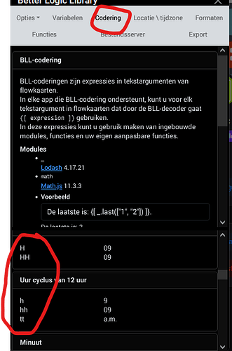

@ChrisG
Please send a screen shot from the BLL settingsscreen with HH format in it?
And update BLL to 3.2.6 to resolve it (after printscreen please :wink: ).
@cgHome What is you locale?
Solved in 3.0.7.

Please let me know the Locale in the BLL App Settings.
Because the Uhr should have been in HH format.
I have resolved it, but wanna see if there are more stuff in there that might mess up formatting.
