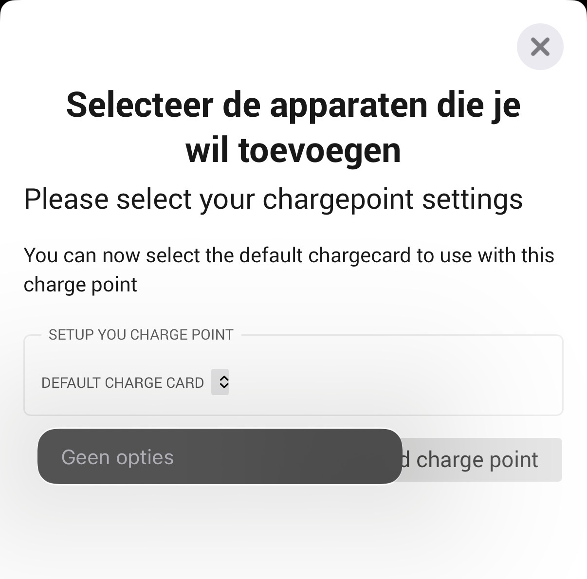

Dear all,
I have a very silly question. I have been ‘given’ a charging point at home for charging my car for business purposes. However, because I have variable rates, it is difficult to do the ‘correct’ monthly billing. I was very enthusiastic when I saw this app. However, I don’t have a ‘50five charging card’. I use the regular Arval charging cards. I can’t configure these in the 50five app either.
Now I want to add the charging station, but I can’t get past this screen. Any idea how I can proceed? Thank you in advance for your help!
In the 50five portal you can add cards under the charge point and enable them for reimbursement, that is a different section then the normal card part.
Once you have your card there, then you can use it in my Homey app for your sessions
Thanks for the info! It seems that I can’t add anything myself. I simply receive a payment for the ‘rate’ I entered into my account. So I think I’m also a ‘guest’. I can’t add a pass anywhere. Can I add my tag manually and/or continue without a loading pass?
Edit: 50five confirms. I always use my arval tags and get the ‘guest tariff’ for all charge sessions. Can I use the app with this situation? I would like to monitor kWh usage every hour in combination with the powerbythehour app. Thanks!
Don’t use their mobile app but the web portal. There, and only there you can add 3rd party cards as new reimbursement cards
Once you did, you can use it in this app.
Their mobile app is very limited.

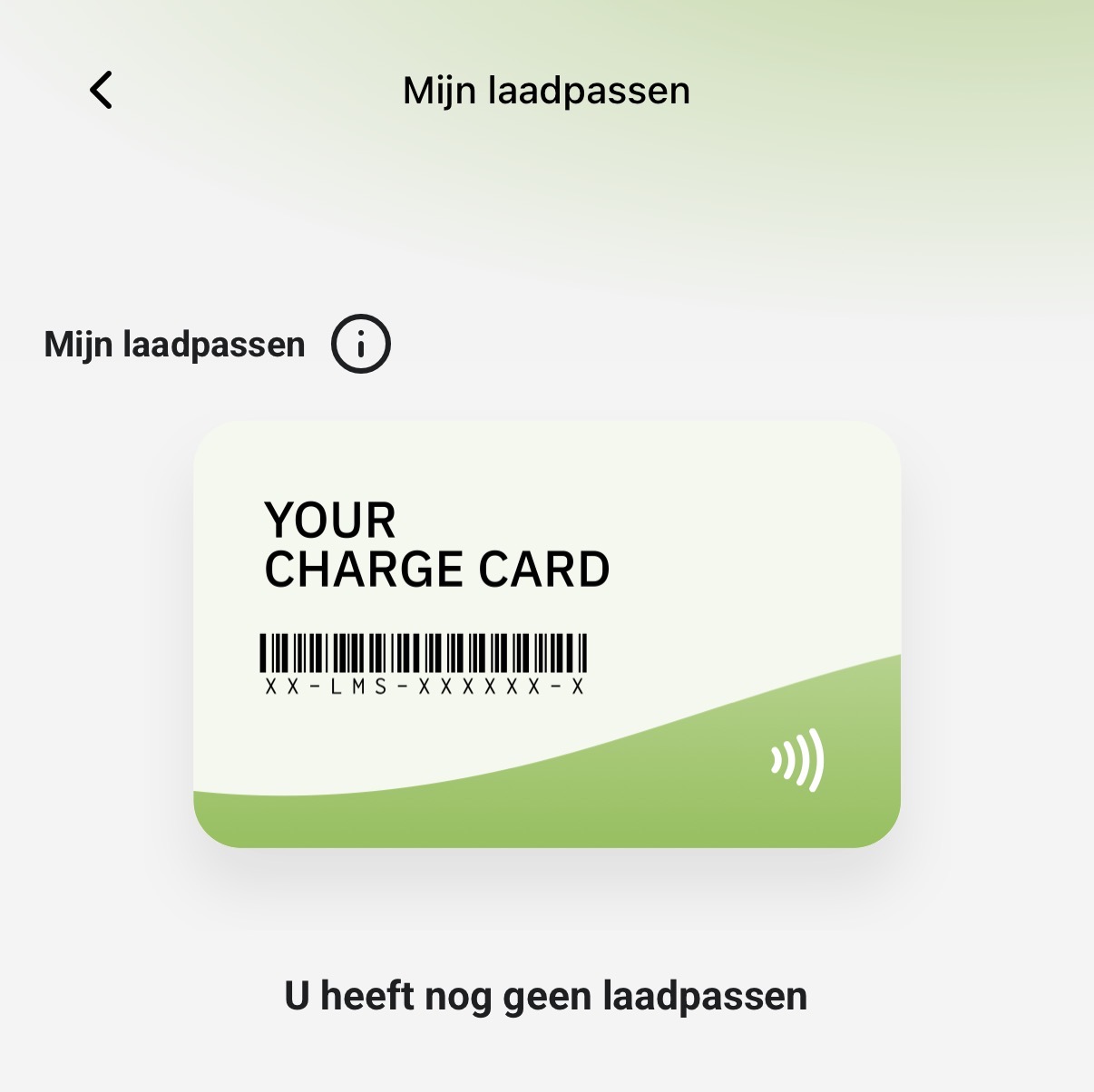

Thank you very much! However, it seems that I cannot/am not allowed to add a card. I have searched everywhere but cannot find a way to add one. Not even on the site (see screenshot). It seems more and more likely that I have duped myself in my attempt to help my employer. 50five does not accept any way of gaining insight into hourly consumption in order to correct my variable rate and only wants the specified rate (which can be adjusted once a month) to be equal to or lower than the actual rate. Local API, rest API, local access, real-time insight into power consumption, they don’t accept any of them. This was my last hope. I’ll just have to accept that this wasn’t a good project for me.

It is indeed weird that you don’t have the add card there. Then you are probably not marked as the owner of the point. That’s required. If that’s the case, ask the owner to add the card.
I have a add card at that menu that I used after the shell migration, new company car last November, and that one works fine for me.
Thanks for your reply. Well, it’s my pole, it’s mounted on our driveway, and I pay for the electricity.
The deal is that it is included in the lease of the lease car. The employer pays for this part of the lease, which gives the advantage of ‘cheaper’ charging. This appears to be a very common practice in the Netherlands. According to 50five, I am therefore a guest user of my own charging station.
