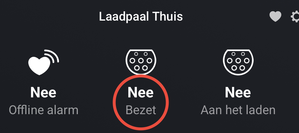

@Kaoh i don’t know if you’ve already answered this question, but is it possible to change the “connected” state based on the loglines?
When I connect the charger, the log lines show “transactie voorbereiden”:
But status is not changed:
Would it make sense to change it based on that log line?
But you can also see it also logged ‘Gereed’ as latest line…
So that is than the status again.

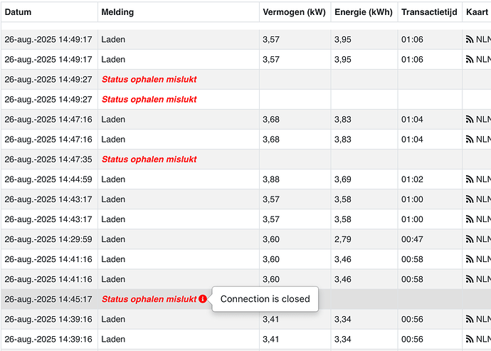

@Kaoh a new situation:
e0ae6a00-807a-43bf-a42e-4cd0c5c629e7
App is not reporting power (0W), but charging session still active. In portal the power is reported, but I also see error messages “Status ophalen mislukt”. The first one is the exact moment the app stopped reporting power usage.
Edit: after 10 minutes it started working again…
