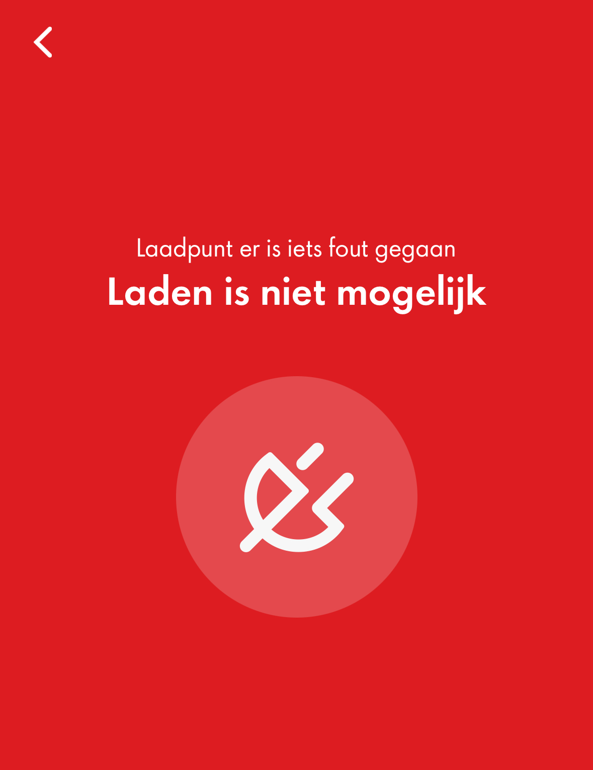

This night charging didn’t work. The charging point was in error. Red led and on website and app there was an error indication. I had to reset the charging point from within the website (or app). Twice….
Is it possible to detect in your app if the charging point is in error (app and website can). And to be able to send the reset command (as action card and from app button screen)?

So looking at your error report, there is indeed a special status for that. But it seems it also triggers the Offline alarm. That one is already supported in the app. On the sensor list there is the offline alarm and you can set it to the tile.
You can also use it in the And conditions from the boolean tag logic actions.
However I miss a trigger to start a flow based on it.
Will this work for you?
I published a new version that includes a trigger for the went offline event.
