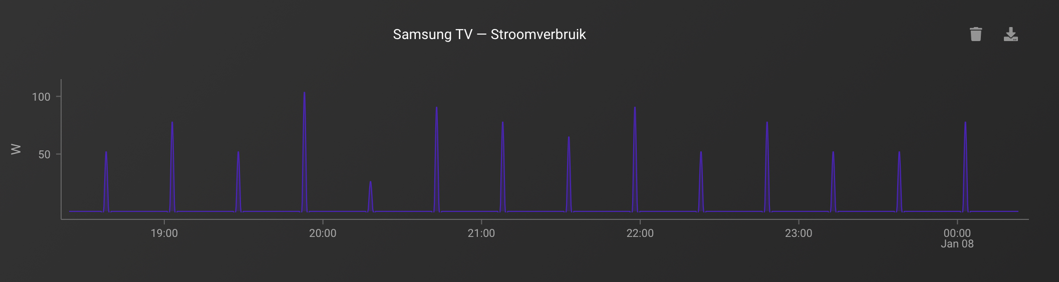

Just for fun I added a “TV ON” counter and let it write a line in Simple Log for monitoring. There I found that the app alters my on/off state every 25 minutes for about 20 seconds. Even the device button in the “Apparaten” view briefly changes. The TV does not actually turn on/off. I guess the TV somehow runs some activity in the background that trips the status in this app. Is this a known issue?
Yes, it’s the network interface on the TV that is actually on…
Blame Samsung :slight_smile:
Thanks for your quick reply. Oké, so basically, when it comes down to the TV ON/OFF state, instead of showing me if the TV is actually switched ON, this app shows me when the network interface is active? In this day and age one would expect there would be an other way to check if the screen is actually ON. But I’m a n00b when it come’s to programming. Making flows on the Homey is as close as I will (probably) ever get to programming :zipper_mouth_face:
I fully trust and respect your skills on this, so… let’s blame Samsung :rofl:
Guess I have to set up a new washingmachine notification flow for the TV, based on actual power consumption to get the counter up and running properly and keep the log from cluttering.
