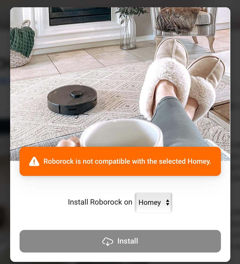

I’m completely new to the homey world. I can’t add the add the app, that’s my issue. See attached image.
Guess you missed the introduction of a new Homey?
Short version:
If you updated the app to SDK3 you have to apply to become a verified developer and/or ask the brand to support.
Then Athom can enable you to publish the app to be also available for Homey (cloud)
No I did not miss the introduction of the new model. Just would not think, and still can’t believe, they’re forcing developers that supply free hours and apps into giving up even more free time. Since when am I on the payroll?
On short notice I do not have the time to make changes for the Homey Cloud. The app won’t work there then.
Guess they are not forcing you. It will even keep working on Homey Pro until SDK2 is removed and afaik that is not yet planned or announced.
The other point is that @oladol is just asking.
No is also an answer imho.
You’re saying that you expect community apps won’t work anymore in the future?
Nope, I say SDK2 Apps work until Athom announces they want to stop support for SDK2. It then stops if Homey’s are upgraded to newer firmware that doesn’t support SDK2 anymore. But that is not yet announced, maybe not even decided by Athom.
Like they disabled SDK1 Apps since Homey FW version 5
  • Homey Apps SDK v1 (Homey < v5.0.0 — End of life)
Nothing changes until then but this App definitely won’t run on Homey (Cloud) when not upgraded.
Ah okay, yeah if they upgrade it will continue to work ofcourse :crossed_fingers:
Would it be possible for me to upgrade the app to the latest SDK? And will that enable me to install the app on the bridge?
I’m a developer, or use to be at least :wink:
Thanks
No,
Nothing can be installed on the bridge, you need to install on Homey (Cloud containers) and that will only be possible if you manage to publish the App to the store.
So if you upgrade the code, become a verified Developer and pass all Athom requirements,
Maybe.
