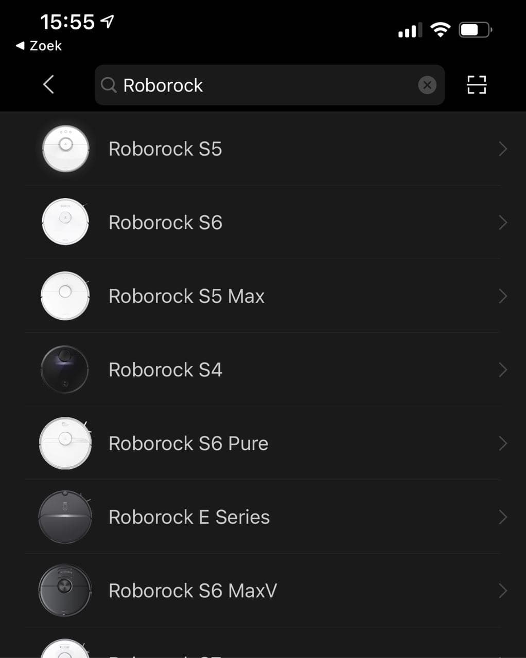

Hmmm. Still no S5Max in the list.
Do you see the S5Max in your list of devices?
I have my region on Chinese Mainland and language on English. Because of the many Chinese Xiaomi devices (and Gateways) i have. Is that the problem that I don’t see the Max versions (in your list i see the S6Max, that isn’t in my list either)?
Running the app on ios btw.

Yes I have S5 Max in the list.
Thnx. Really strange.
Maybe someone with an iPhone can confirm that they also have the S5max on the list? Maybe it is the Chinese Mainland as a region….

On my Iphone it has the S5Max too
Yeah, the problem is Chinese Mainland as a region.

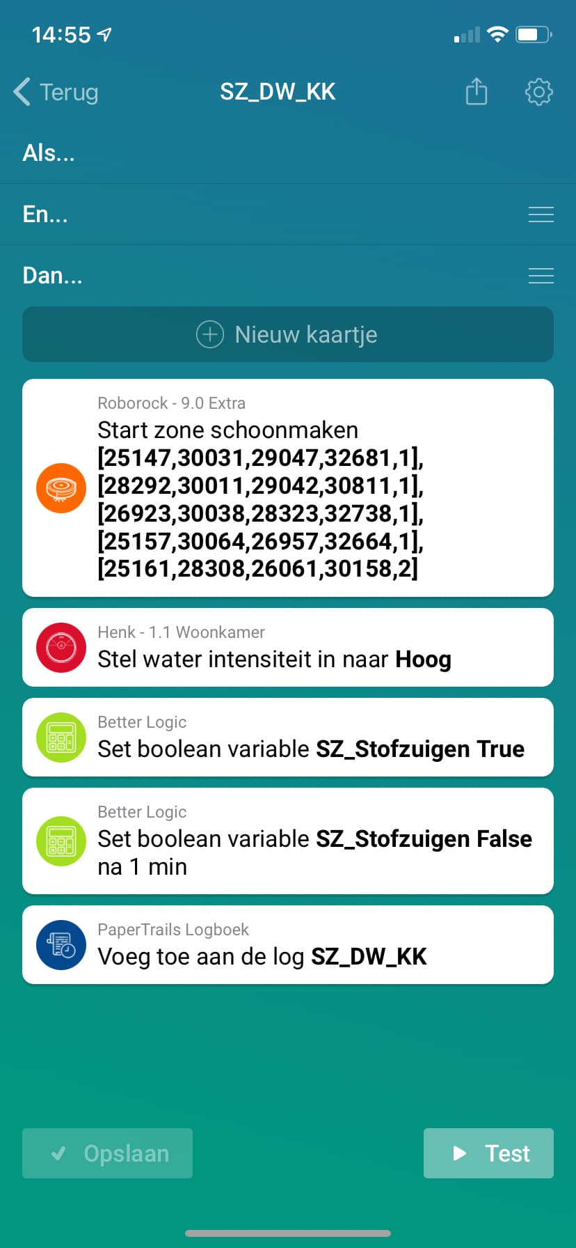

My question is about multiple rooms in one flow and the same room twice. The same for zone cleaning. I’ve 2 examples what I mean. The orange (Roborock) is another app (from the link) and the red one (Henk) is your app.
Edit: sorry it was the wrong link. Here is the correct one:
https://github.com/Maxmudjon/com.xiaomi-miio/files/6760401/Roborock_Zones_Goto_CleanRooms_WaterMode.zip

I am not a fan of the multiple zones cleanups. Yes, this might work, but I wish to keep the app as simple as possible without getting errors off wrong input all the time. Creating this function in this way will not allow dummy users to add information in the right input box and then run the flow, they need to be sure they’ve typed everything in the right way and that’s not an option for me, sorry.

I use a android app (in a simulator) for getting the xy locations. And the output is exactly the same as I had to enter in the line. So that’s made it easier for me.
Which android-app do you use to get xy locations? FloleVac?

Yes flolevac. Works really great.
But I’ve only iPhone so had to use a simulator on my Mac
