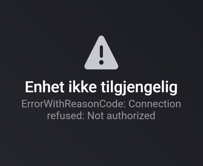

My S5 Max is just blinking (between the two bottom images) after adding it. Tried both with password and token. Logs in successfully without errors when adding it.
I used the old app before, so I added it to the Roborock app before I added it in Homey.
Could you submit me a diagnostics report?
Here: e3abf6a7-5f15-4ba1-9106-d62c63c033bd
It seems you get authorization errors from Roborock. Can you try to repair the device? Or maybe reinstall the app.
Thanks, I removed the app and installed it again - seems to work now.
