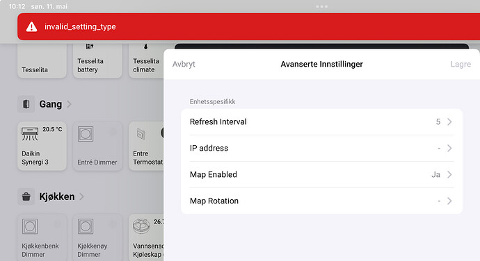

But: The advanced settings for my only Roborock (S8) doesn’t seem to work either. I can see the map in the device page - so it’s clearly updating - but the device settings for «enable map» is «No». And if I try to change that setting to «Yes» I get an error message «Invalid setting type»:
My install is running in Norwegian - so «Yes» is «Ja» and no is «Nei» - but I would believe that this is managed by the OS.
Did you restart the app after changing the option?
It’s impossible to change the option. It’s stuck on «No» even though the map is obviously enabled - and I can’t change it to «Yes» or anything else. Any attempt to do so just generates the error message. This is persistent after restarting the app.

Could you maybe send me a diagnostics report after trying to change the setting?
Sure.
Everything is set to auto update - so the Homey (2019) is at 12.4.2. The Roborock Cloud app is at 1.3.0.
Diagnostics at e745677f-bc36-4acb-89ec-66fef8f96d6b

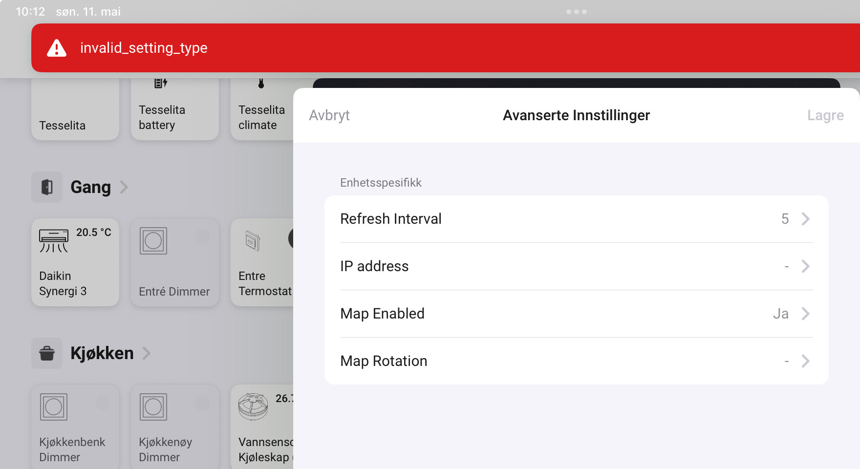

Same error message as in my previous screenshot.

Hmm @Sportswagoneer, now I’m really puzzled. The logs don’t show anything wrong with it, so that doesn’t make me wiser at all.
It cannot be caused by language either, since my installation is in Dutch.
The only thing I can think about is that Homey 2019 somehow doesn’t support these kind of settings. I had similar issues with using the ‘label’ setting type in the past, which worked nicely on a Homey 2023, but not on earlier editions …
I’ve noticed that I did not provide a default value for the setting, I’ve done that now with v1.3.1 and put it on disabled by default. This version is now in test.
Can you try if that gives you better results?
Thanks. That worked!
Not only did the map dissappear after updating - but I can now use the settings to turn it on and off.
