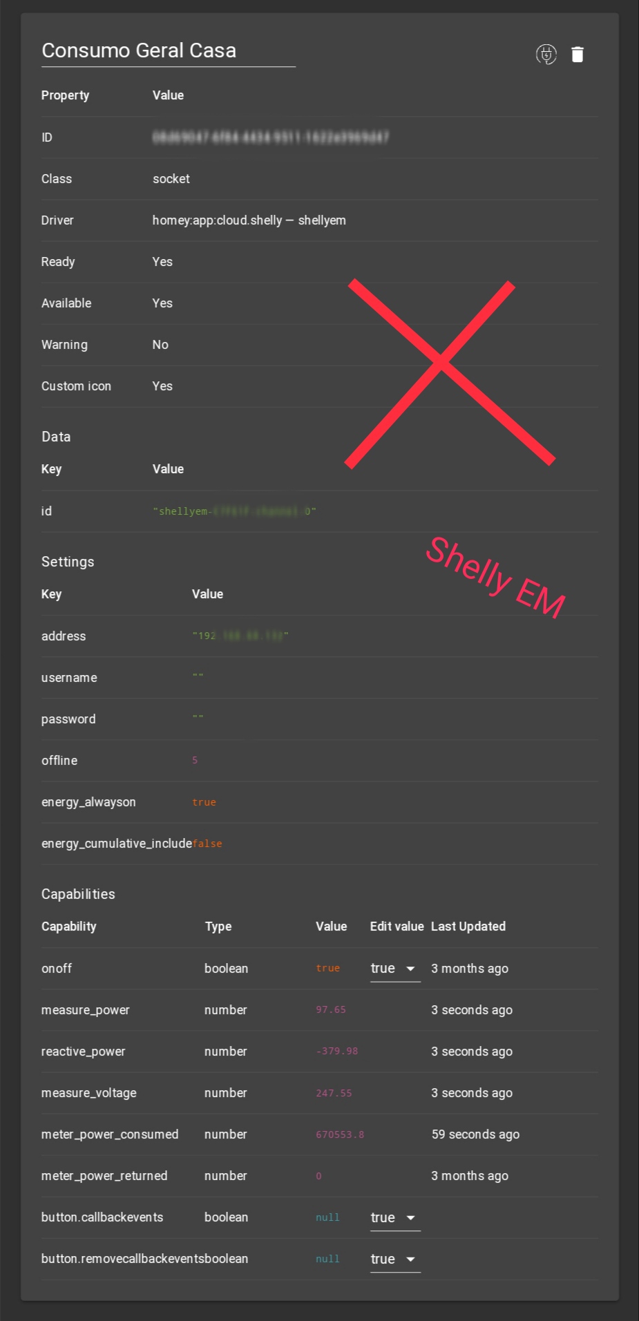

Hello.
I started using this app today.
I use a lot of shelly devices, all my ‘Shelly 1PM’ And ‘Shelly 2.5’ are detected fine.
But the ‘Shelly EM’ Wich is a Energy Meter can’t be added.
Does it not have the required capabilities?

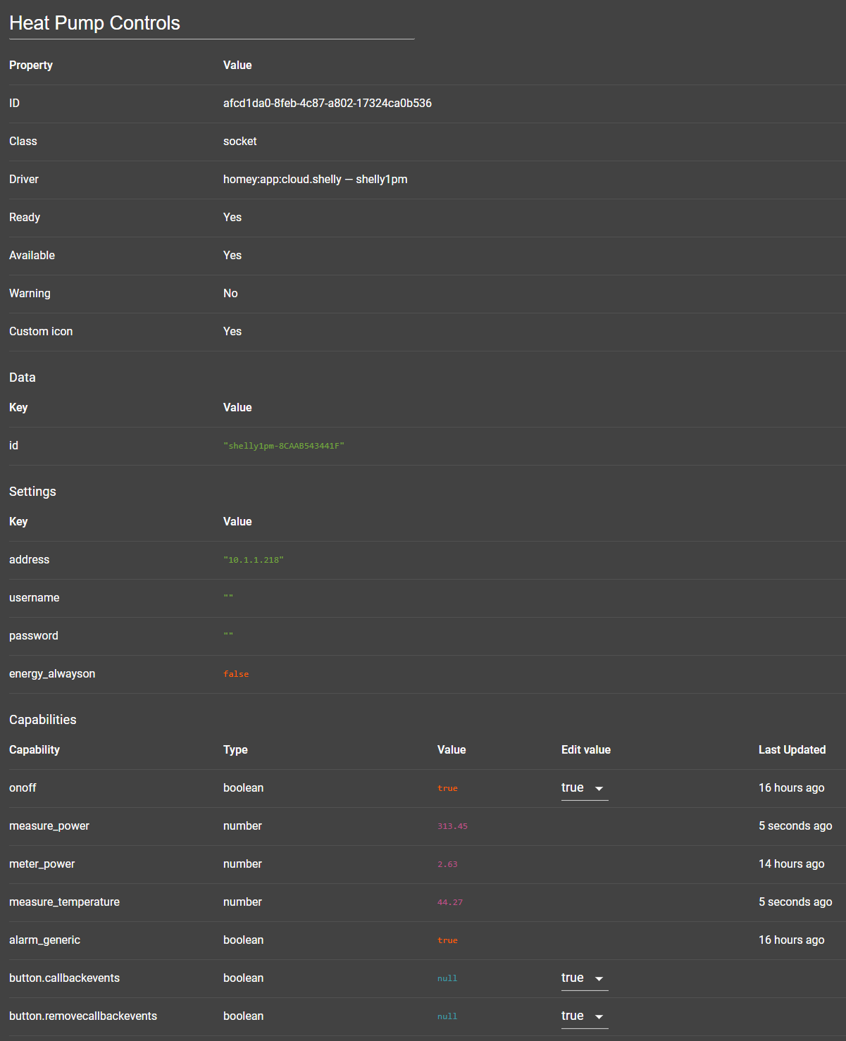

Thx for the App, seems to work great for some devices like TP-Link, Youless and Plugwise. However It doesn’t seem to work with the Shelly 1PM. I can add it but all values stay zero…
Already removed it and added it again and tried restarting the App.
Any Idea?
Power by the Hour
Shelly 1PM (image limit per post)
Does shelly reset the meter_power to 0 every day maybe? If so just enable this in the PBTH advanced device settings.
Try to restart shelly app. I had this issue with Shelly 3EM
Great, this did the trick. It’s indeed restarting the Shelly App and not the PbtH App that solves the issue.
Thx!
Hi @Gruijter
Would it be possible to add support for the shelly EM?
Thank you
I checked the code for the shelly em app. It has a meter_power. So what is not working then?
Or are you using it for production (solar panels) maybe? I see there is a meter_power_returned. PBTH does not support that indeed. Just connect the solar panels as a power user in stead of producer then…
It is not detected by pbth , when i go into add new devices it just doesn’t appear on the devices available to add.
No I’m not, i just use it to measure the total consumption of my house.

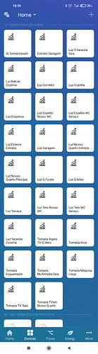

Thats weird… Unless it is already added to Homey, it should turn up. You do see other power devices?
Yes, and already added to homey.
Although non of them is a shelly EM, the devices you see on the screenshot are either “shelly 1PM” Or “Shelly 2.5” or “Aqara Eu Plug”
Can’t understand it either :smirk:

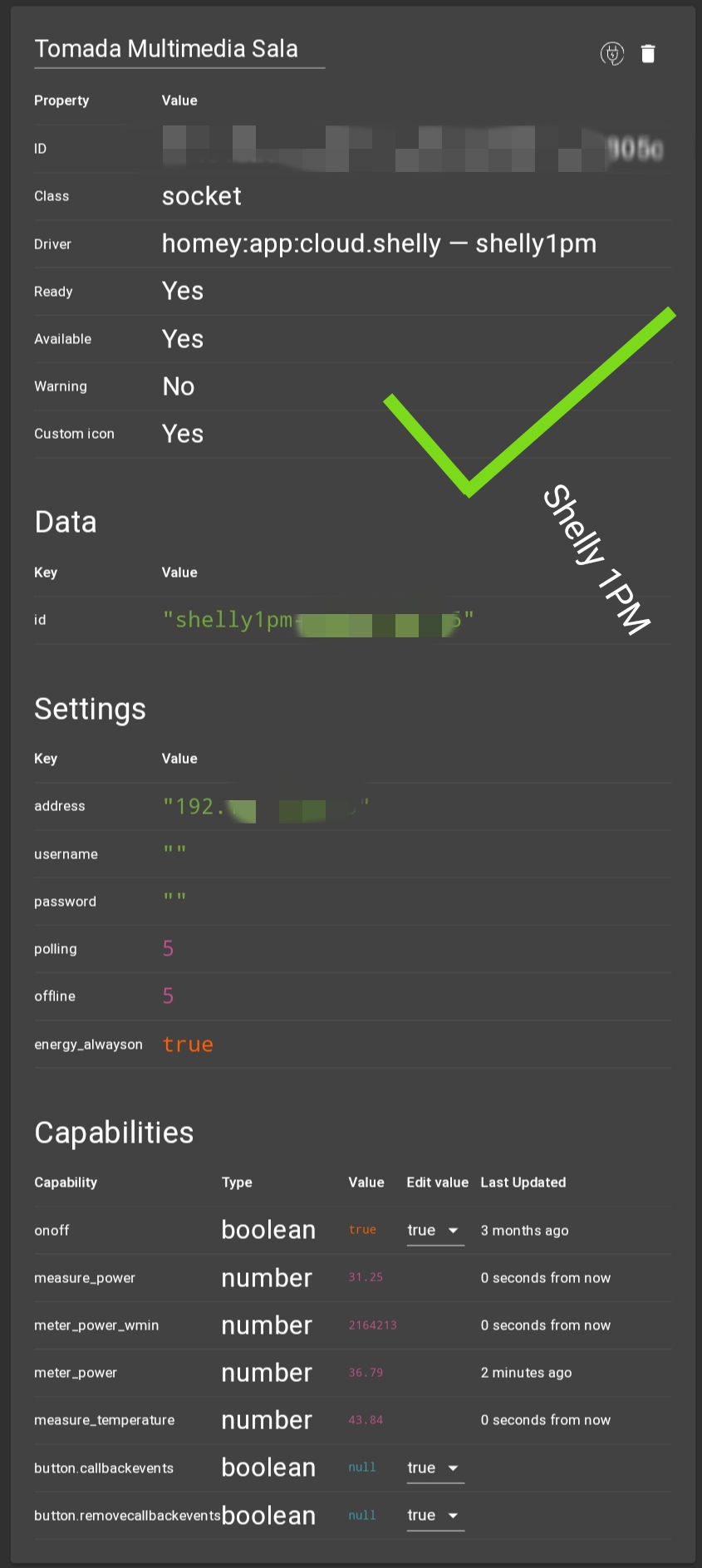

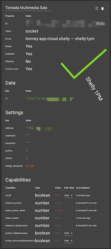

These are the differences from the device info i can get.
Red Cross: Doesn’tget detected by PBTH (Shelly EM)
Green check: One of the many I’ve already added with PBTH (Shelly 1PM)
Both from shelly.
@Phuturist Do you have a clue why Shelly EM is not showing in PBTH during pair?
Only thing I can think of is because the Shelly (3)EM are currently both registered as cumulative energy devices as these devices are often used as some sort of energy clamp and you dont want to double count the usage. See https://apps-sdk-v3.developer.athom.com/tutorial-Drivers-Energy.html. There is a request though for adding an advanced option allowing the user to change the energy attribute similar to your Enelogic app but I have not yet implemented that.
