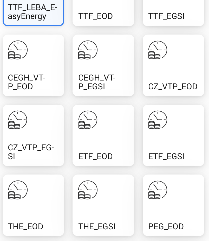

And I have another question that I can’t find an answer to. I’m probably over-reading it, reading too much information.
But I want to enter the gas price of Zonneplan. Which one should I use then?
TTF_EGSI
Zie (helemaal onder aan bij de vraag “ Hoe wordt de prijs van dynamische energie bepaald?”)

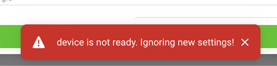

I get this in my screen:
What I do, I get every time this in my screen (one I put 21% BTW and the price)
Can someone help me with my problem hier up? Thank you @Torch1969 for your help but I can’t put a number in the: Vaste opslag per m3
Try restarting Homey, and try again after 10 minutes
Yes, I have put the information :slight_smile:
But I still se nothing, is that because the new price is not yet given?
TTF Egsi source might be broken. Could be temporary, or more likely I need to fix something in the app.
TTF Leba can be used as alternative, but might have small deviation to egsi.
