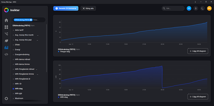

Since the update to v5.7.0 the “Money today” variable is not resetting at midnight:
Noticed this yesterday, and then did a restart of the app and a manual correction of the value, thinking it was a one off, but unfortunately not… :frowning:
Diagnostic report: f42e4b25-f359-41b2-8bd2-df78bb34bbce
Will investigate. Thx.

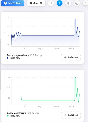

Sorry if I missed it as a known bug, but the Energy prices weren’t updated here, since around the 20th of August:
An app restart like 4 days ago (prior to the v5.7.0 update) solved it.
Homey v8.1.6
PbtH v.5.6.9
Any clue? Little chance of finding what was wrong I guess?
Other parts of the app worked fine:
Correct. An app diagnostics report just before the app restart might have provided a clue.

Unfortunately v5.7.2 did not reset the daily use at midnight:
New diag. report (if you need it): bb94b928-65cc-4c53-bf71-d283be4865c9
For me the kWh daily reset still works, but money daily reset doesn’t work (since 11 sept.) I’m on experimental version 5.7.2 now.
Diag report: d6f77d95-7211-4297-abe9-5e3e91e8827e
Hi, same here, money keeps adding. Also on exp version 5.7.2
Bummer :confounded:
