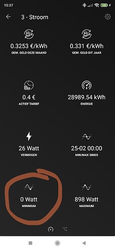

Would it be possible to allow this value to be negative:
When Power used becomes lower than Power generated due to solar panels, this value drops to zero, but Power is actually negative (generated).
That is already supported.
What is the source device and app you are using?
