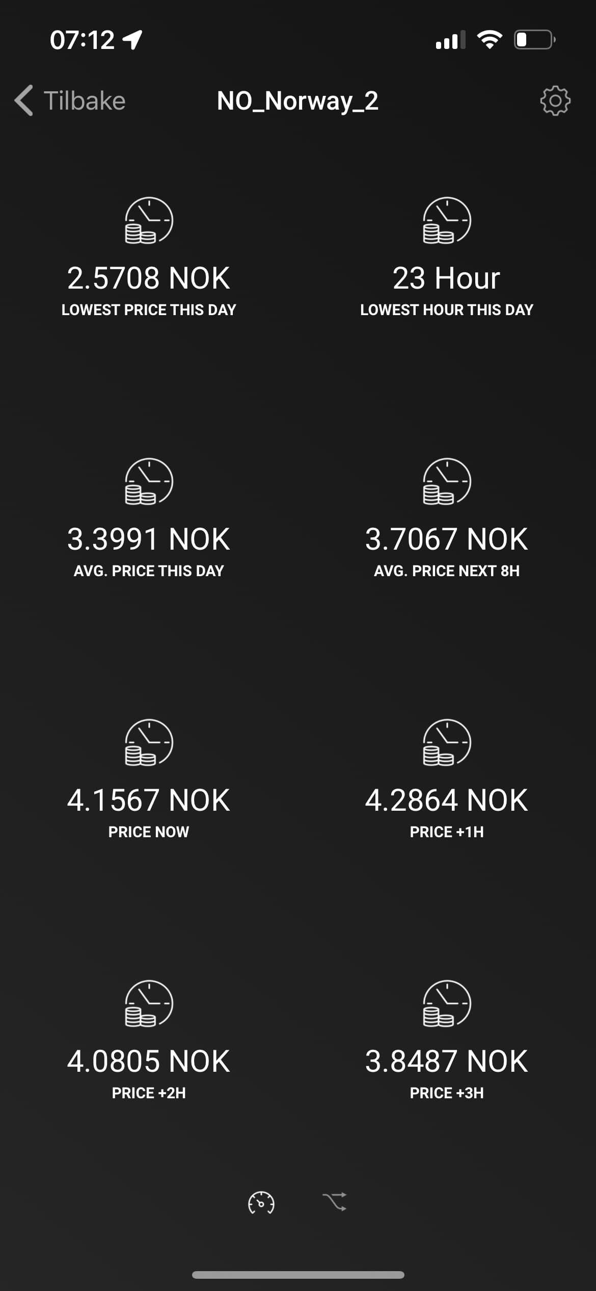

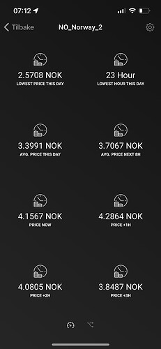

Wrong, in EUR:
Correct, in NOK:

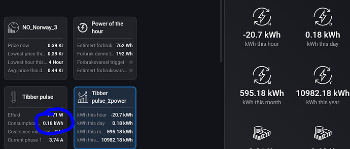

Sorry to bother again… I struggle to find out why the hourly meter went backwards the first hour of the new day. The first hour should equal the value of the day. Appears as the meter is stuck on a value read before midnight. The hint says the value is updated once an hour. This probably is the reason, but what is the reason for this design??
Yes it should. Can you send an app diagnostics report? And can you download and send me all the indights data from past 24 hrs of tibber pulse and its pbth device?
Thx!
Edit: oh, and you can confirm you did not update any device settings manually or via flow?
