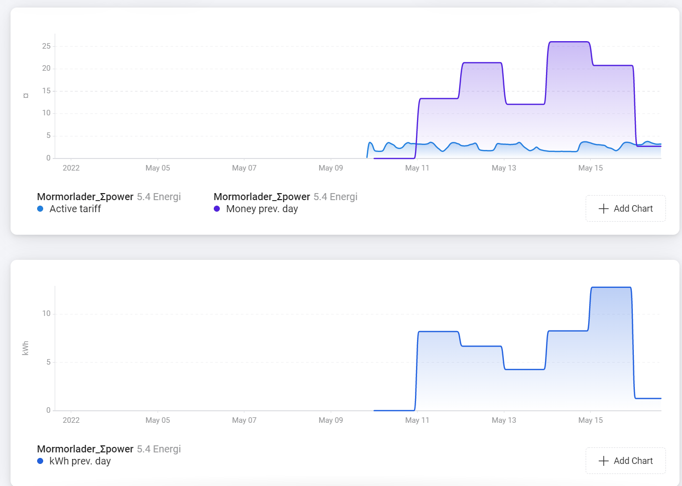

For me, the “kWh prev. day” and “Money prev. day” tags doesn’t seen to sync. It seems that the price is way too high compared to the consumed kWh yesterday.
https://homey.app/f/QTRwc3/
Can you share a screenshot of the corresponding insights for the last 7 days? (kWh prev. Day, Money prev. Day, tariff)
Sure, on the screenshot, it seems that they are syncing correctly, but on a time scheduled at 1 o’clock (as you can see in the flow), it was showing 20.76 as money prev day and 1.28 kWh prev day.
The “kWh prev day” can also go in minus:
It’s hooked up on a Shelly S plug.
Does the shelly device reset its kWh every night?
Are you using watts or kWh as source input?
What is the shelly device measuring? (E.g. solar panels or …)
No, the Shelly plug reset its kWh every week. I’m using “Power” (in Watts) as source, and I use it for car charging.
What is also strange is that the charger has an idle consumtion of 1.7 watts, but it shows 0 watts in the power summarizer attached to the Shelly plug.
When I’m having a closer look on another Shelly plug, the watt curves on the Shelly Plug Watt and the Summatizer Watt does not sync 100% as you can see here, were suddently it consumes 50 watts in the summarizer, but not in the Shelly Plug.
That is because the summarizer derives the watts from the (in your case virtual) kWh meter, and then averages that over 2 minutes. So the shelly watts will always be more accurate then PBTH.
Did you try using kWh as source, and then switching on ‘source resets at midnight’? That might work better for you then using watts.
Ok, I thought that the Shelly plug was automatically using the actual watt consumption, but it uses the kWh instead, and that value is reset (by the Shelly itself I assume) every monday at 18:00.
Maybe that’s the reason for all this misinformation!
I will try to enable “Use Watt as source” instead. I can’t really see any other solution on this.
The Shelly Plug has 2 types of reading; Power (which is actual watt consumption) and Energy (which is accumulated kWh, which is reset every monday at 18:00. Apparently this accumulated value can’t be reset from within Homey or Shelly app, so it can “align” with the summarizer every day at midnight.
I was wrong about when it reset the kWh meter. The first time on this graph was after a Homey reset, and the other…I don’t know! But the thing is that I can not rely on this kWh reading from the Shelly plug.
I’ll try to use actual watt consumption instead.
