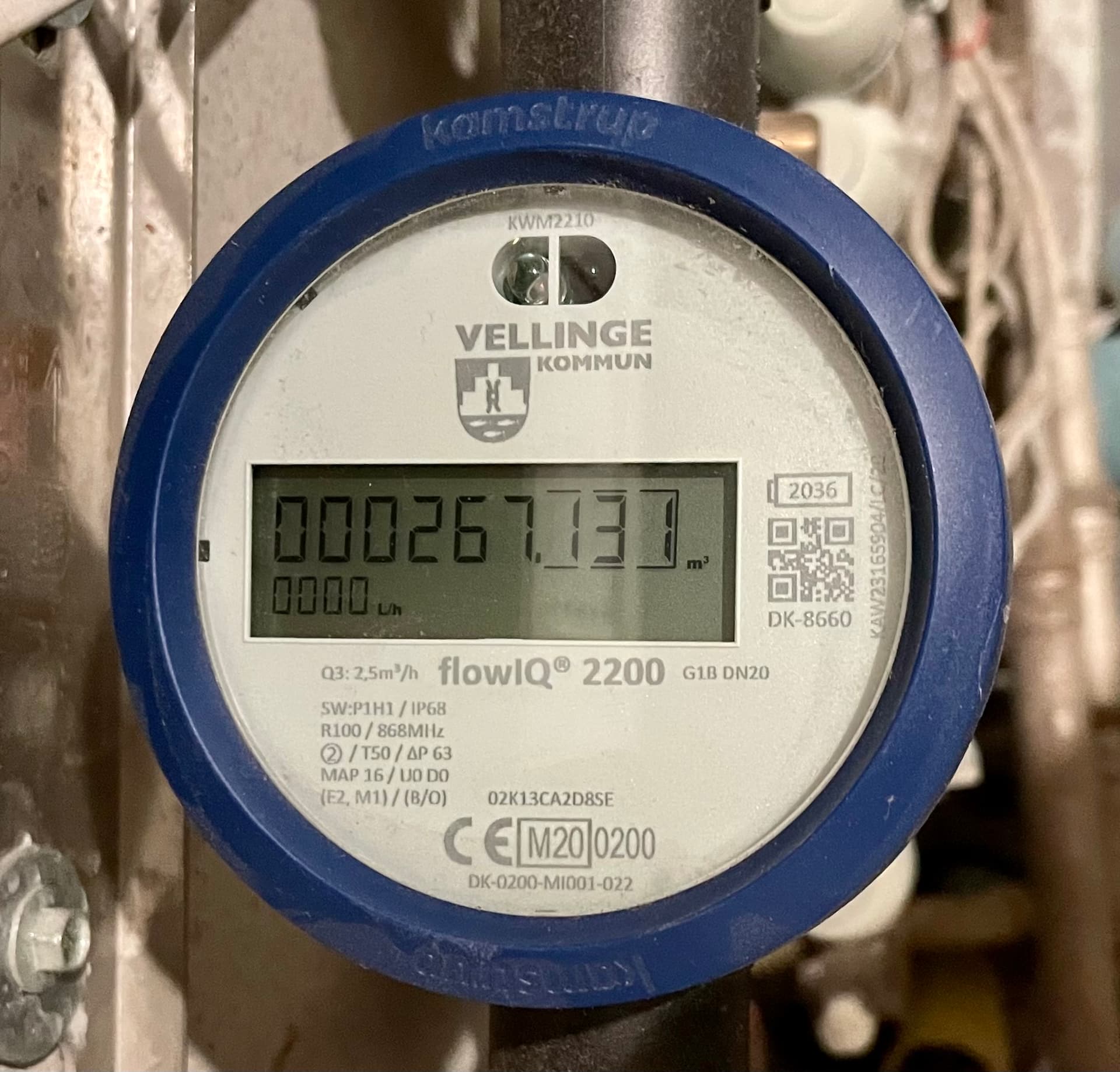

I am a happy user of this app in the electricity side and would now also like to measure my water consumption. What is the best unit and solution for this purpose?
My water meter looks like this:
Do I see an LED pulse on there? If so you can probably use the Youless LS120.
I do not see any LED pulse when I have water consumption!
Can this pulse be seen with the naked eye? Can it be turned on/off somehow?
Wrong place to ask. Ask your supplier what interfaces the meter can supply to the outside world.
All I know is that the Youless can work with a pulse, either LED or dry contact… Also the youless has a Homey app that supports a water meter that can be used by PBTH.
