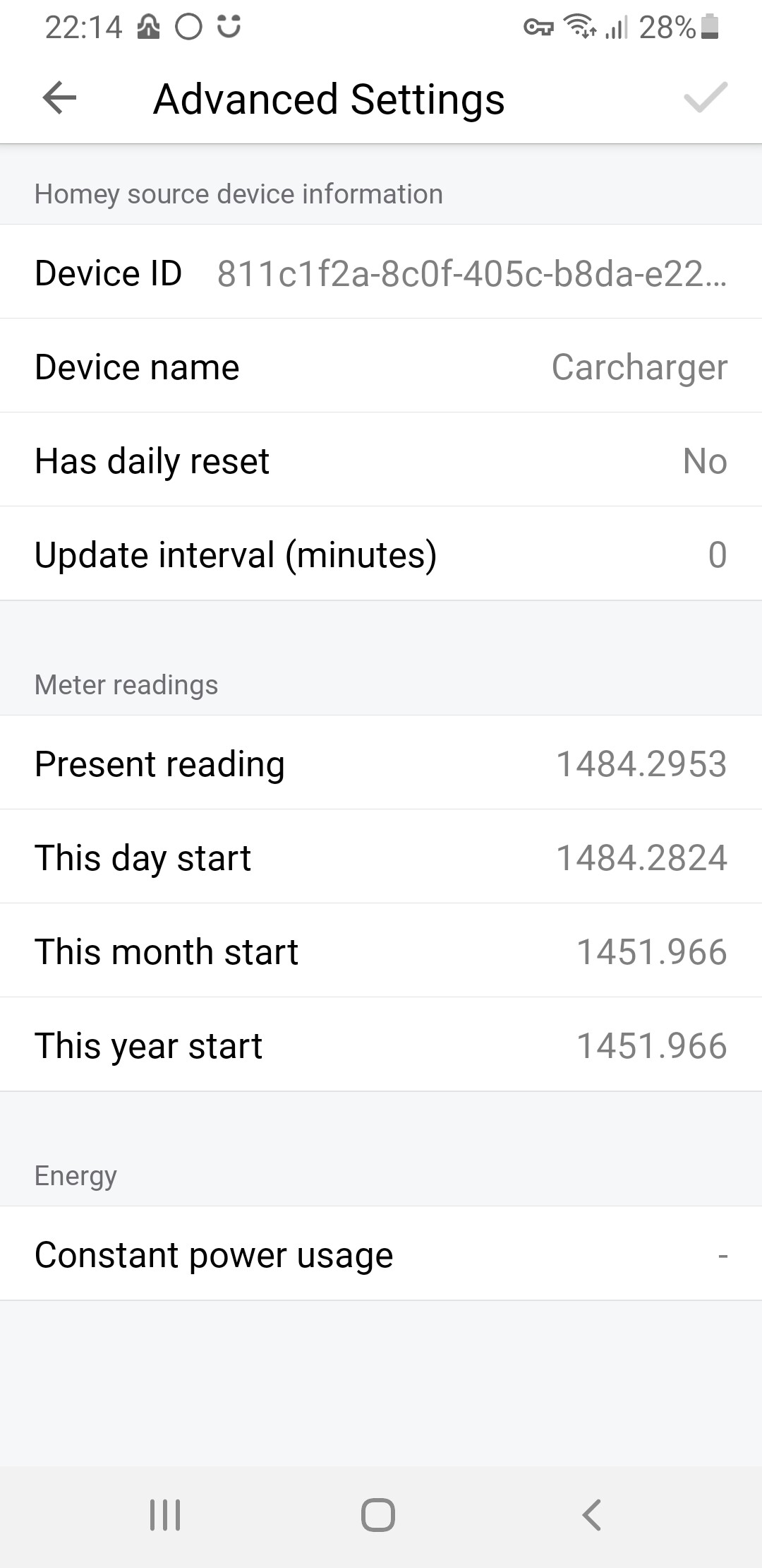

Yes you can set the start of year and start of month in advanced device settings.
@Gruijter Thanks. I will give it a try.
In advanced settings there is a daily and hourly value of 32.72. If I change the value of the month and yyear from 0 to 72, that is the real value, the app says 32.72, then the hour and daily value change to -32.72 and the month and year value change to -72
The app resets every day to 0. So I can see the value of my solarpannels daily. Only the totals for month and year are wrong because I was to late with the app.
After five minutes the value for month and year was 35.72- The hour and daily were 0.
I wil look at it tomorrow.
Update: The app needs a bit of time to change the values, now it shows the right numbers.
Thanks.
