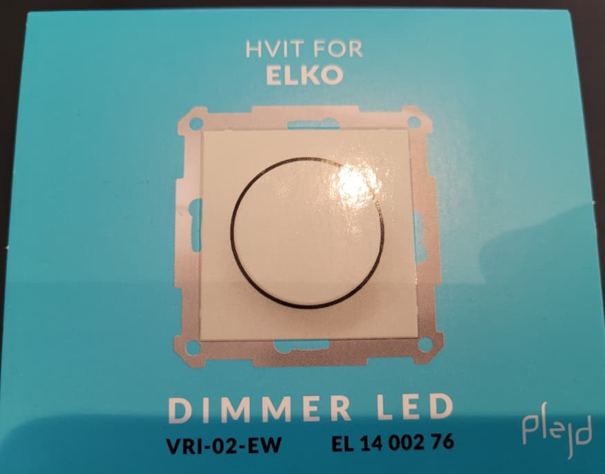

I have bought this Plejd product and I can’t get it to work with Homey.
Both the normal and the test version of the app gives me the same result.
Isn’t this product supported or am I doing something wrong?

What device (e.g. DIM-01) do have attached to the button? You can add that device to Homey, not the Button it self.
I will respond you on Github.
