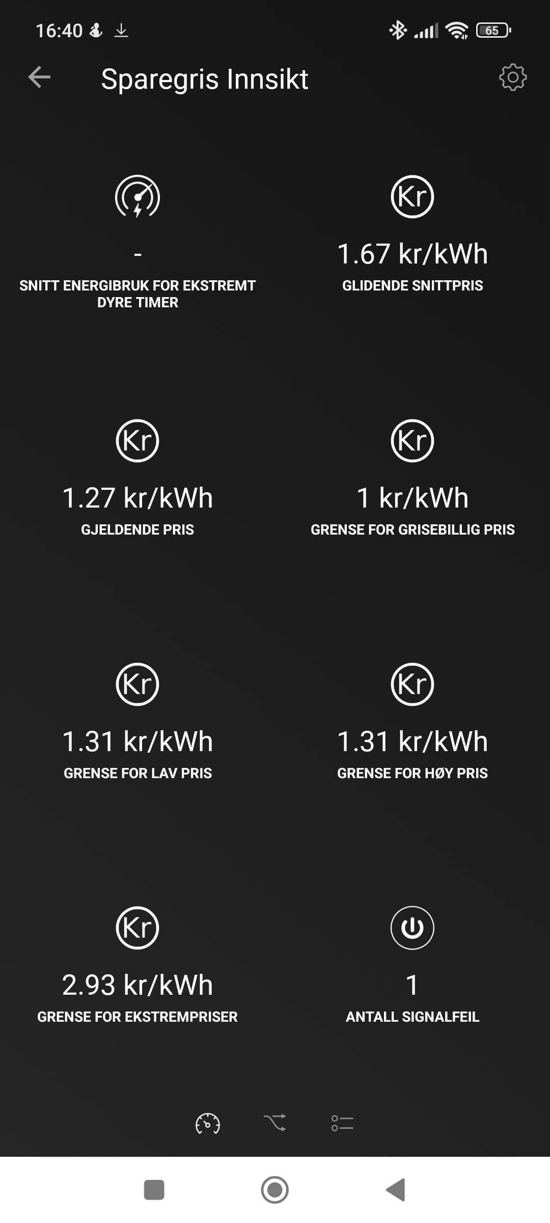

I can’t seem to be able to turn off minimun cheap/expensive hours a day. I’ve tried setting them to 0 and leaving them blank, but the app keeps setting the price point for low and high to the same price point lower then the average.
Am I overlooking a setting, or is this a bug?

hmmm… Could be a bug, unless that change won’t have any effect before the next hour starts (I don’t remember). Is this the case or is it still behaving as if low and high are the same?
They were last sett 16 hours ago(at midnight) and the extreem price points keep changing as normal.

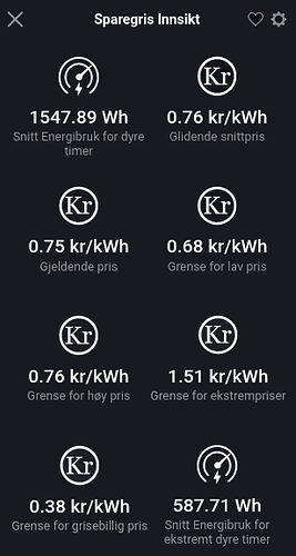

But are the low and high limits equal still or do they look more like this?
They are still sett to the same price point, as they have been for ~17 hours now.
Yes, i had Tibber before as operator, and handling of smart charging, but that is disabled, and Easee is now set as operator.

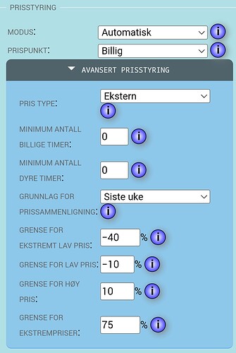

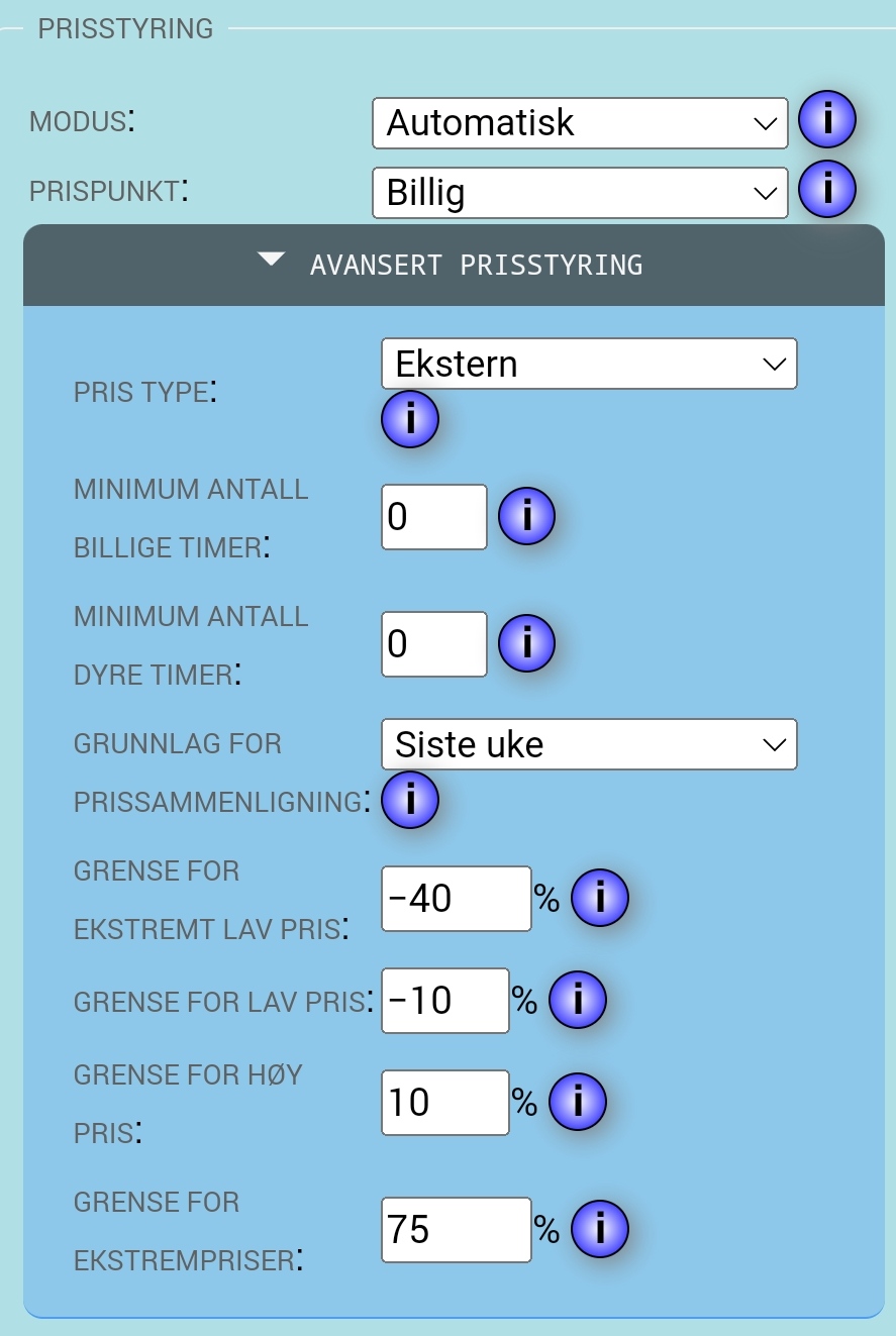

I cannot see from the price you have reported above (1.27 kr/kWh) where the prices was fetched from. None of the price regions in Norway had this high prices yesterday. Can you please indicate what your price settings are?

Prices was fetched from Strømregning app. So that would be including nettleie and all that.
And for the effect the price point had was that I got 1 “normal” hour at 17:00 yesterday when it should have been “cheep”.
Same today. The low price point should be 1.44, not 1.21.
