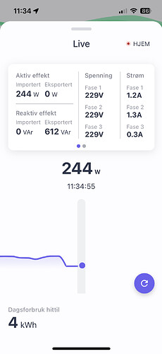

Installed the Oss app in Homey and it went well, but information about current power usage and information about the individual phases is missing. The values shown are static (do not change). Everything works fine and shows the correct values in both the Oss and Vibb apps. Tried to log in several times, reinstalled the app and repeated logins without it helping the problem.
Homey:
Oss app:
Vibb app:
Continued this evening with repeated new attempts (deleting app, reinstalling and logging in) and suddenly it just worked! Don’t know what’s causing it, but finally up and running with everything, including integration with Homey and the app “Norwegian Electricity Bill” (Strømregning) :smiley:
