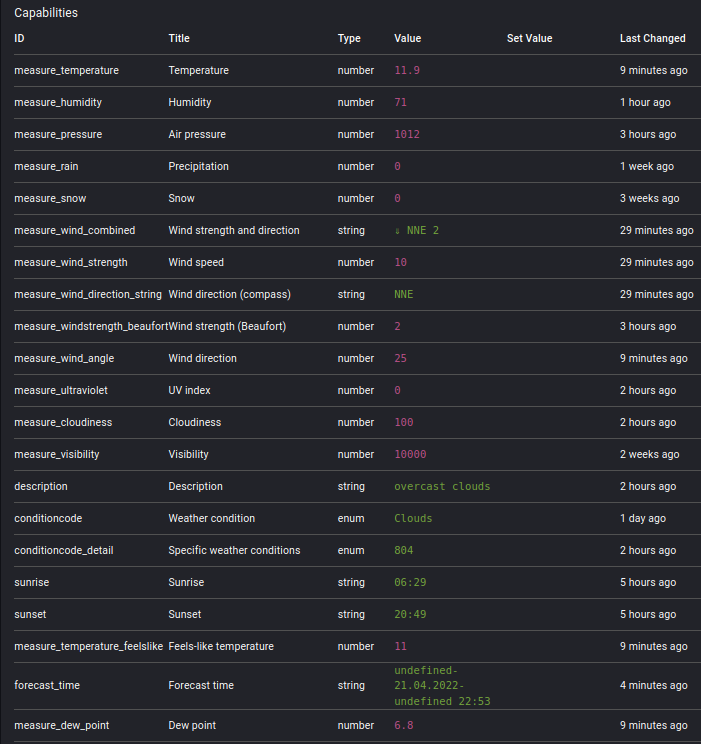

Hi Peter,
can you send me a screenshot with the complete date from the capability list in developer view?
I have an idea what could cause the problem.
The current firmware (or NodeJS) delivers the date (as local string) as yyyy/mm/dd independent of the localization. Now it seems, the date is converted into localized string as dd.mm.yyyy.
Ofcourse.
I didn’t look there yet. The time is present and correct, but now the string is too long to be readable in the app :wink:
It says undefined-21.04.2022-undefined 22:53
Is this the cause of ‘undefined’ (drivers/owmOnecallCurrent/device.js line 207) :

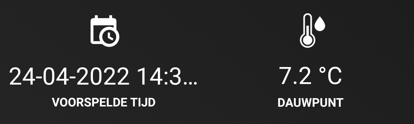

Ok, next try: test version 1.1.10.
The time should be hopefully ok now.
Is the format DD-MM-YYYY what you expect for your location (- instead of / or .)?
Again, thanks for testing!
YW and thank you
It’s OK now
Yes that’s the usual format in NL
Is it because I haven’t updated yet?
date is still wrong. dd-mm-yyyy is what i want
but it is now mm-dd-yyyy.
