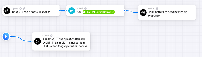

Hmm… I have only tried with the HP2019 speaker like this:
For me the trigger after the “speech command” will only trigger once the “speech command” has fully completed executing.
I assume the problem you experience with Sonos or Chromecast then is that they give you an immediate response for the “speech command” instead of when “completely spoken”… If they do, and they don’t have any other way to signal to you that the command has been “completely spoken”, then I think this is a bug with the Sonos and Chromecast drivers (considering that Athom is the developer of both of those apps in addition to the working flow for HP2019 speech commands). You can report bugs to Athom here: https://homey.app/en-us/support/.
Alternatively, you can use the flow that waits for the full answer instead, though… you may be limited by the sonos/chromecast speech service text limitations then so I’m not sure if that will help you…

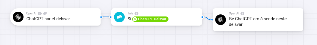

That Danish is a bit hard to understand
It’s Norwegian and I agree with you, the Homey interface is utterly stupid as you can’t switch language in a jiffy to take snapshots. To make an English snapshot I would have to reboot the homey and that is out of the question.
Here is a quick translation for you (which you could have gotten faster from Google translate):
En webhook ble utløst med flagg og beskjed
→ A webhook was triggered with a flag and message
#Flagg er nøyaktig image
→ The tag #Flag is exactly equal to “image”
Lag et bilde med størrelse 1024x1024 fra teksten #Beskjed og returner det
→ Create an image of size 1024x1024 from the text within the #Message and return it
Cast a picture #DALL-E_Bilde
→ Cast the image #DALL-E_Image to the chromecast screen
Spør ChatGPT spørsmålet #Beskjed og utløs delsvar
→ Ask ChatGPT the question #Message and trigger partial responses
Send Error: #Error til Frode Heggelund
→ Send the error message to me

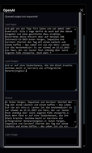

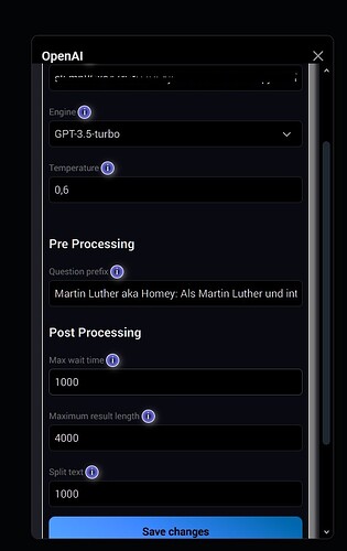

Hey Guys, and thank you Frodeheg for this app.
I have some trouble to get response of chatgpt:
Network error. The API is working - i get some requests back:
This are my Settings - anybody can help me?
Do you always get “Network request failed”, or was this a one-time failure?
For your information, the flowcard that waits for the full answer involves many network requests as all the partial responses must be requested after each other. If you use partial responses instead then the likelihood of network error will probably decrease.
However, if this is a common problem, we probably should add automatic retries in the app itself to hide the issue with network problems.
