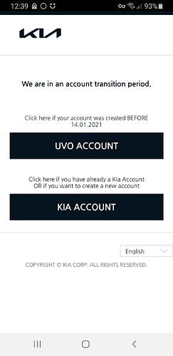

The new version 2.4.1 is assuming you have migrated your account already to the new Kia/Hyundai account. If you did not already do so, follow these steps to migrate the account:
Also make sure you use the same credentials for the new account (same username, password and PIN)

And for people with issues during login: make sure you have upgraded to the Kia/Hyundai account:
  1. log out of your official Bluelink/Uvo app
  2. Login again using Kia/Hyundai account
  3. Create new Kia/Hyundai account and use the same username/password/pin as before
  4. From now on you can login to the Bluelink/Uvo app using the Kia/Hyundai account
If that doesn’t work, try changing your password from the official Uvo/Bluelink app. If the password change hangs, press SKIP. After changing it you need to match the settings in Homey - advanced device settings.

all is good here. Does the UVO/Bluelink app work? Did you upgrade your account? You need an upgraded account!
Yes the UVO app is working fine. And the upgrade is only for accounts before 14-01, right?
