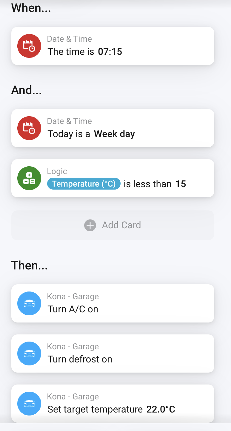

hi @Gruijter managed to get the app working well so far. have set up a flow to turn on the car’s A/C and defrost at 7:15am weekdays when the temp is below 15C. The A/C turns on without a hitch but two days in a row the defrost hasn’t come on. Any idea why this might be? could it be because I don’t have the car plugged in (i charge at work)?
I had the same thing once this week from the official UVO app. Can you test if that does work?
