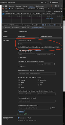

I added my Kia Niro 2023. It’s a bit complicated to get the token but after a few attempts and readying carefully the instructions on step 1 I finally was successful (Open your Browser new (best is Chrome), CTRL+SHIFT+I, CTRL-SHIFT+P, type ā€˜network conditions’, uncheck ā€˜Use browser default’ and set the following user-agent: ā€œMozilla…)

These are the instructions:

What we would need to have is basically do same method as HA did with tokens, the script seems to work fine, the HA integration too BUT homey apps don’t yet have the token support.
I used that one: bluelinktoken.py Ā· GitHub
