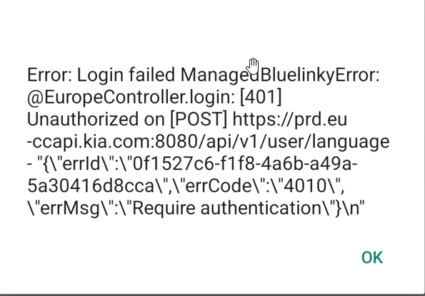

I keep getting this error when trying to link my bluelink account:
What is different is that when I choose USA as a region, I actually get ‘incorrect username/password’ errors instead, which is as it should be.
Could there be a bug in the app in how the message values are sent to their servers when Europe is set as the region?
No. The different regions use completely different authentication methods. EU region is using the most complex methods to secure the api.

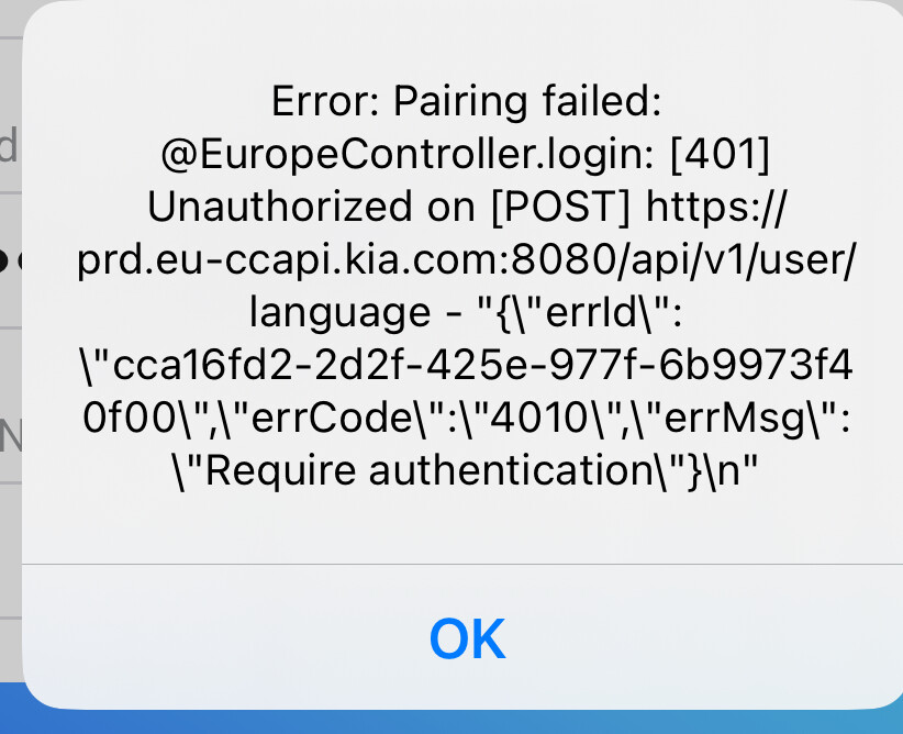

I am having the same problem here. Tried to connect my EV6 to Homey Pro for the first time today and have same error code 4010.

I received the dreaded exclamation mark on my EV6, and after removing it, I now get the error message below.

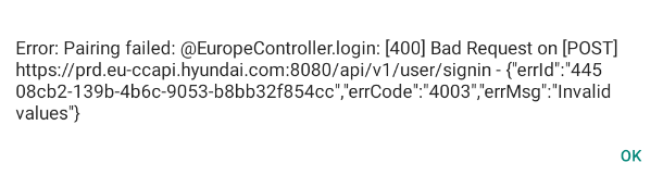

Exactly the same problem with the Niro. First a red exclamation mark and then the same error message with the new installation.
But I can reassure you. Nothing is working with Home Assistant at the moment either. We will probably have to wait.
