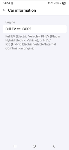

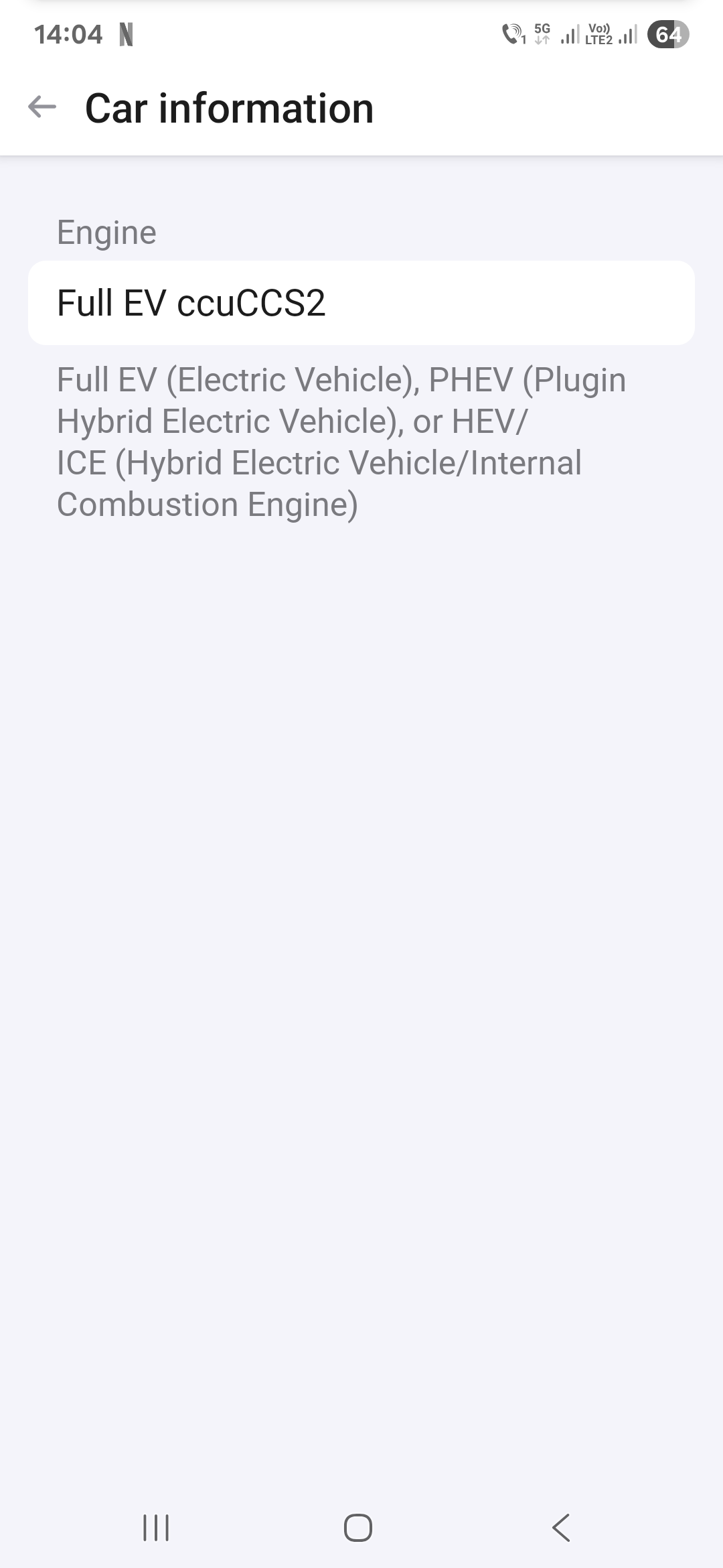

Has anyone else had the issue where the 2025 Hyundai Kona HEV is seen as a Full EV (Full EV with CCS2)?
Cheers
LE: @RM_de_Gruijter, here is the report code (if necessary): f0b3a2b1-034f-4fbd-8d8b-35c0ef9bee11
Will check it. Thx for the report!
v1.2.2 is ready for testing:
  • Fixed detection of ccuCCS2 HEV. (@AdyBOSS please verify)
  • Added HP2016/2019 warning in readme.
  • Fixed support link.
Unfortunately still Full electric.
Checked app (experimental), restarted Homey.
Still Full electric.
1617124f-7f8a-46fa-9a70-67c879c13be3
Did you delete and re-add the car?
Nope. I thought it is received from server.
But I just did it and now it is correct HEV :grin:
Thanks dor the quick fix.
