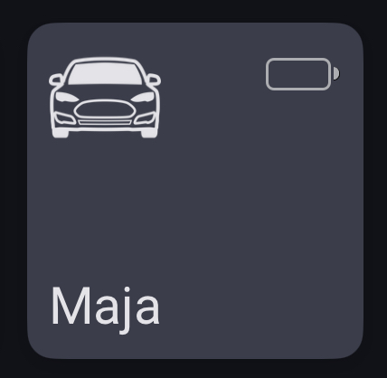

I have the same issue as Manar. Car detected as HEV but is full EV, Kia EV9 in this case. When forcing to change to EV, the SOC on the EV battery is 0%.
