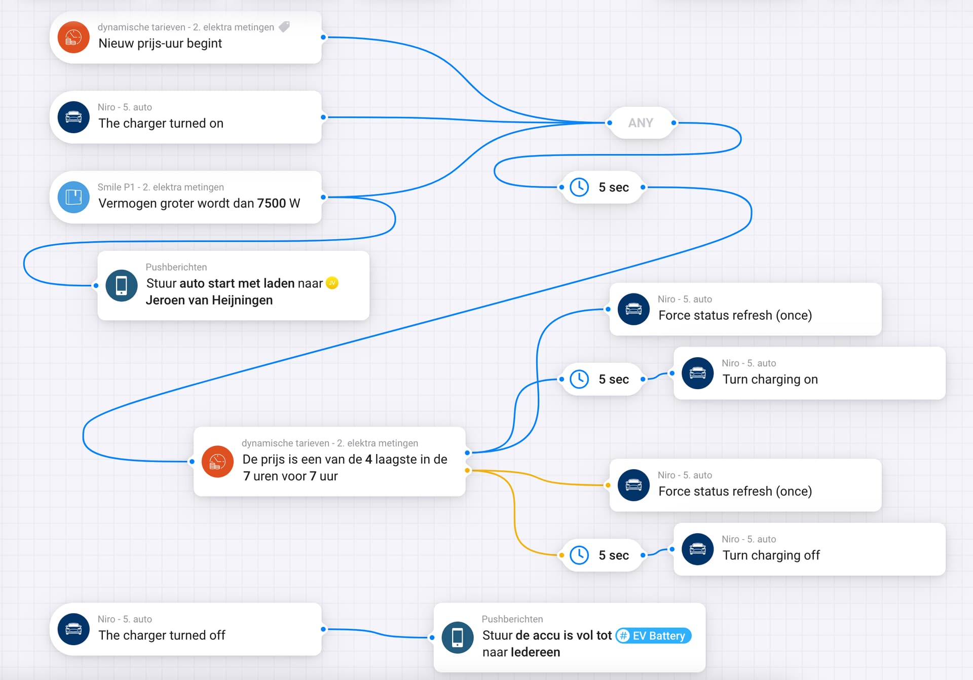

Hello, when I added my car (BlueLink) to my Homey Pro, I logged in and everything, the settings look correct, but the data isn’t updating at all. It lets me start my car, but that’s it.
Here’s the diagnostic code: 157bcba4-54da-4966-9d87-f7e422498164
How can refresh my car status to open my garage door when i come home?
How Works the http get method? What should i write in Body or Header?
Help pls.
with this flow the problem is not solved. Is there anyone who can have a look what maybe can be the problem?

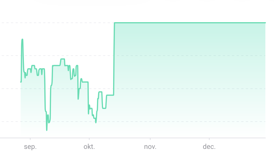

yesterday the 12volt battery was empty. According to homey it was 100%. Now that I look at it hasn’t been updated since mid-October. The other data is normal. Does anyone know if I can reset this or something?

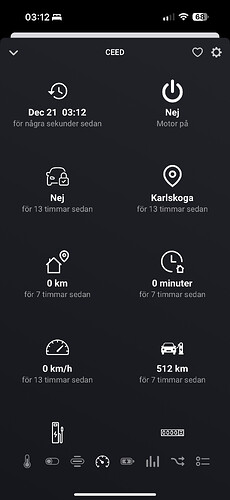

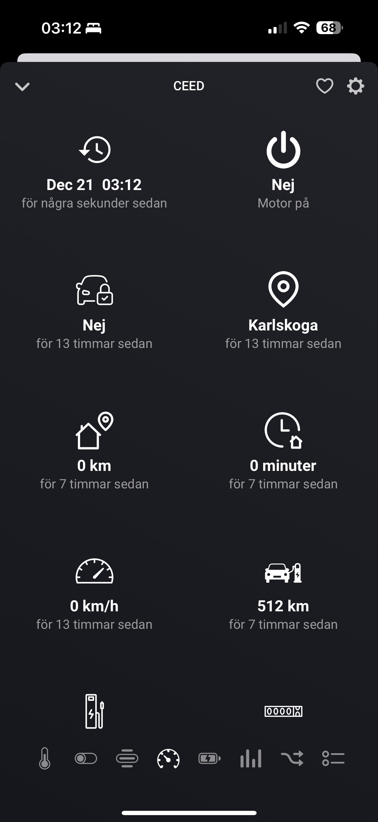

Indeed odometer and location capabilities are not updated at all. I’ve been using this car for a little more than a month now and odometer never received a value at all. Location (and ETTH and distance from home) received a value once, but they were never updated. Also the location was 8km off (my car was actually at home then).
See screenshot below. None of the values make sense. I never drove 511km/h. :smiley:
There are only 2 capabilities that seem to get updates continuously, which are 12V Battery% and Climate Temperature (the set value on the climate system).
