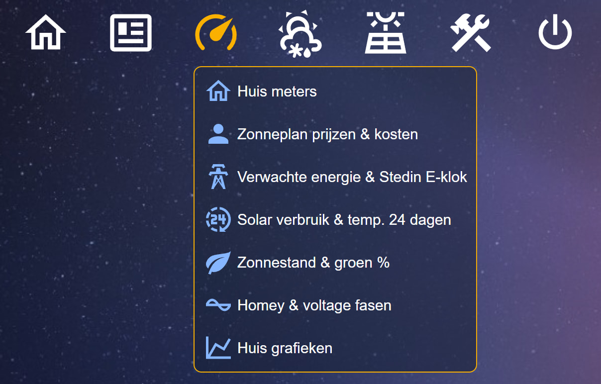

First menu prototype using one horizontal menu and multiple vertical menus:

The orange button in the main menu and selected submenu shows the currently activated menu.
Selecting another submenu from another main menu. In my example below is the blue Solar main menu.
Short: what is my active menu (orange) and what is the main and submenu I am selecting (blue)
