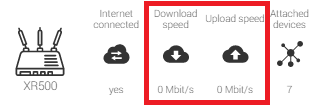

Hi!
First of all, very good work! This is awesome! :slight_smile:
I bought a new Netgear router and for some reason, the app will only work partly. The model I have right now is: Nighthawk Pro Gaming XR500. I can add the device and the test says that everything is fine (see below) but the traffic is not updating (always 0), it will not notify me if I deactivate/activate WiFi on my cellphone multiple times (presence). The first time it worked (when i Connected to WiFi) so it seems that the updates wont go into Homey all the time. When I check the log, it is not updating (even if I press Refresh button), any clues? Its running in router mode.

NetgearApp
Did you did enable traffic statistics in the router?
@n1z
@Gruijter wonderful! :smiley: So simple and effective! Thanks! :smiley:
